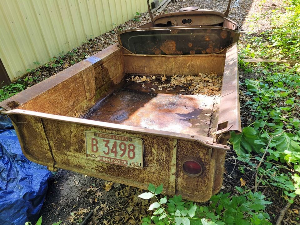

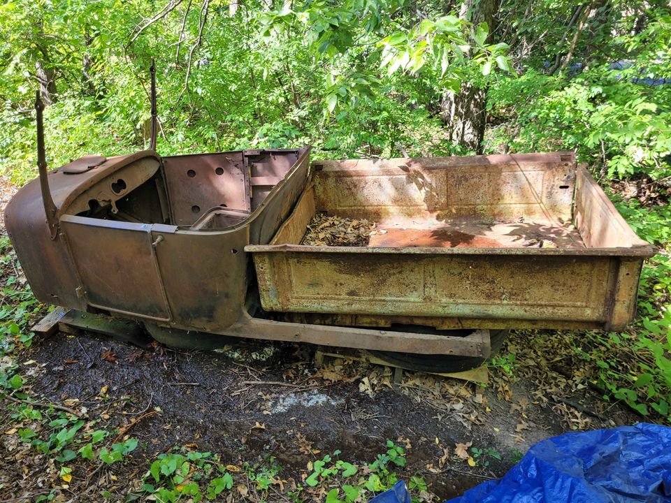

I am curious if this is a 25 pickup box. It has a reinforcing piece inside the box but no provisions for the fender irons.

Sure is ! Not a common item to find either - the rear irons are rare but cam use a modified late touring iron & body socket.

Looks like a good one. The fender iron brackets appear to be gone, but the box looks like it has a lot to offer. Usually the center brace is gone, because many of them have been removed for trailer use.
