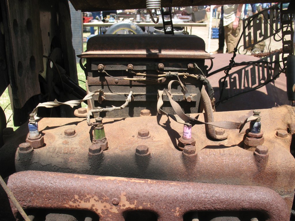

The barbed wire adds a nice rustic touch.

When using custom spark plug wires it's nice to have a colorful variety of plugs.
