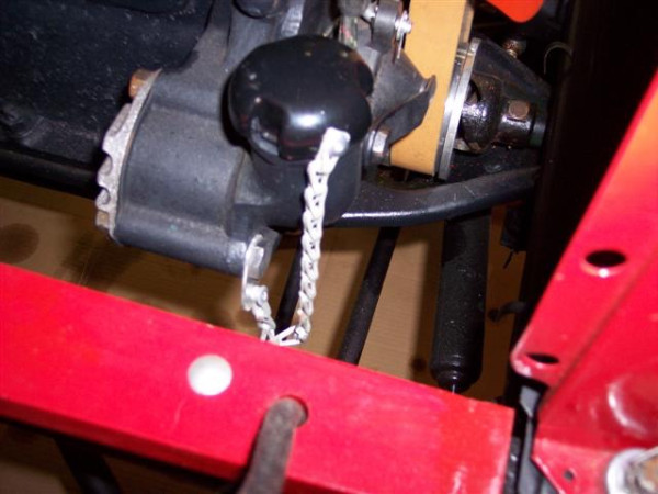

Where did you park for lunch ? If it was a twist fit, chances are it didn't walk off on it's own. Our '14 Touring had the original brass cap modified by soldering a 3/8" brass flat washer to some brass chain which in turn was placed over the timer clamp bolt and the other end soldered on the top edge of the cap.

I know Tim - hate to think the worse but sh_ _ happens !
That's very much like what was on ours.

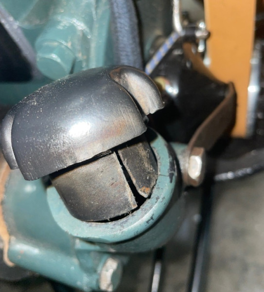

The "tube" part that goes into the timing cover is a bent round piece of sheet metal.
I spread the seam a bit @ the bottom to create a sort of spring tension. Squeeze the base a bit to install.
The cap is tight in the cover.

After that collar is round for tension, then bend a ‘tooth’ on the edge with the needle nose. That tab will grip the front plate hole and secure the cap for the roughest roads!

The bent tab or moving one side over just a bit works for me. I can’t just lift my caps out. There is definitely tension on them. Ford didn’t use anything to hold them down that I know of but not 100% sure.

I solder a chain to the INSIDE of the cap, and wrap it around the bolt.
