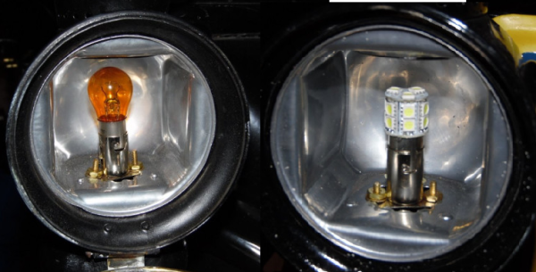

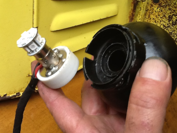

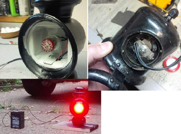

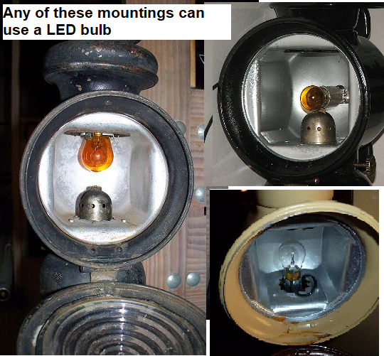

You can purchase a 12 volt sport battery (I got one for a trolling motor because its a deep cycle design that allows it be recharged many times unlike a motorcycle style battery). Ah, ampere hours, is the spec to look for. Led's don't take much so a 100Ah battery driving a 2amps of LED calculates a 50hours but likely an easy 45 hours of continuous use.
Also are you just interested in a tail light or one that functions as tail and brake light?
Recent discussion https://mtfca.com/phpBB3/viewtopic.php? ... ed#p234988 --
Here are some past discussions. Google'd led oil lamp mtfca
https://www.mtfca.com/discus/messages/2 ... 1332691923 https://www.mtfca.com/discus/messages/7 ... 1500812760 https://www.mtfca.com/discus/messages/8 ... 1537302804 https://www.mtfca.com/discus/messages/4 ... 1418346769
https://www.mtfca.com/discus/messages/7 ... 1514737510
