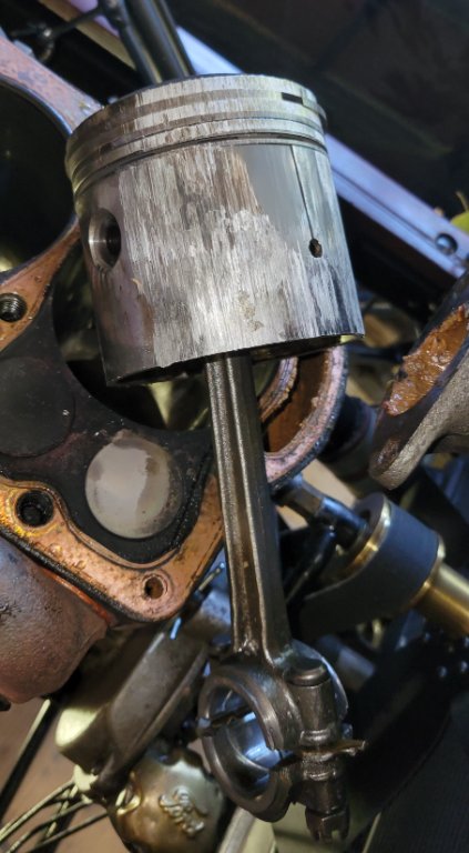

It was a bad day on Saturday.
Does anybody have a single aluminum piston and rings, 0.060" over sitting on a shelf?

Did the wrist pin seize to cause this? How many miles on overhaul?
Re: Bad day touring...
Post by Norman Kling » Mon Oct 03, 2022 4:13 pm
What does the cylinder look like? Piston might be saved with new rings, but if cylinder is badly scored, it will need to be bored or sleeved. That doesn't look like a wrist pin was too tight. It looks like there might not have been enough clearance between the piston and the cylinder. Aluminum pistons expand at a greater rate than cast iron and if the engine overheats, it can score the cylinder.

Which cylinder on which T, Keith ? Something got too hot or not enough piston to wall clearance!

It is #1 on the 1911. The car I'm planning to take to California in 20 days.
Oil was a little low, engine running cool.
Been running fine for 10 years.
Stopped immediately, so only a little score. I think it will clean up fine with a hone.
Now... about ONE piston and rings...

That looks odd to me. Could the cylinder be out of round? Rod bent? Oil pipe clogged? Ring gap issue, stuck ring, or broken ring?

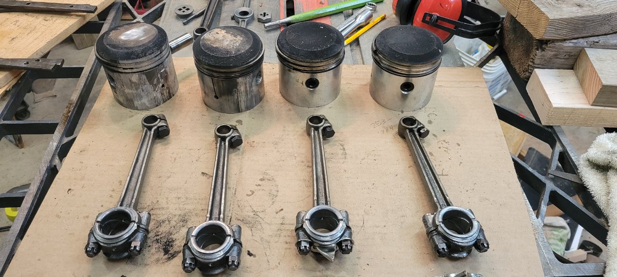

Keith- check the rod for pin alignment- the appearance of the thrust surfaces of the piston and the fact that the scuff marks are on the front/rear sides of the piston are an indication of a twisted conn rod.

The rod looks bent in the photo.
Posts: 8444
Post by TXGOAT2 » Tue Oct 04, 2022 10:11 am
What would lead to a bent rod in an engine in service?

I think that lack of oil caused this problem. Not a broken ring

Question: "What would lead to a bent rod in an engine in service?"
Possible answer: Accidentally starting the engine with the spark lever too far advanced.

You have the engine all apart? You are honing cylinders? Replacing all four pistons and rings .060? Straightening rods? I would think that would handle it.
Posts: 1503
First Name: Keith
Last Name: Townsend
Location: Gresham, Orygun
Post by KWTownsend » Tue Oct 04, 2022 11:50 pm
Yup...
Taking up the rods, too. And will check #2 main too.
Got the head resurfaced today, too.

# 2 piston also looks scuffed. I'd suspect low oil level or some issue with the oil pipe. I'd want to make certain the stock oil pipe was 100% funtional and I'd want to add a good auxilliary oiler.

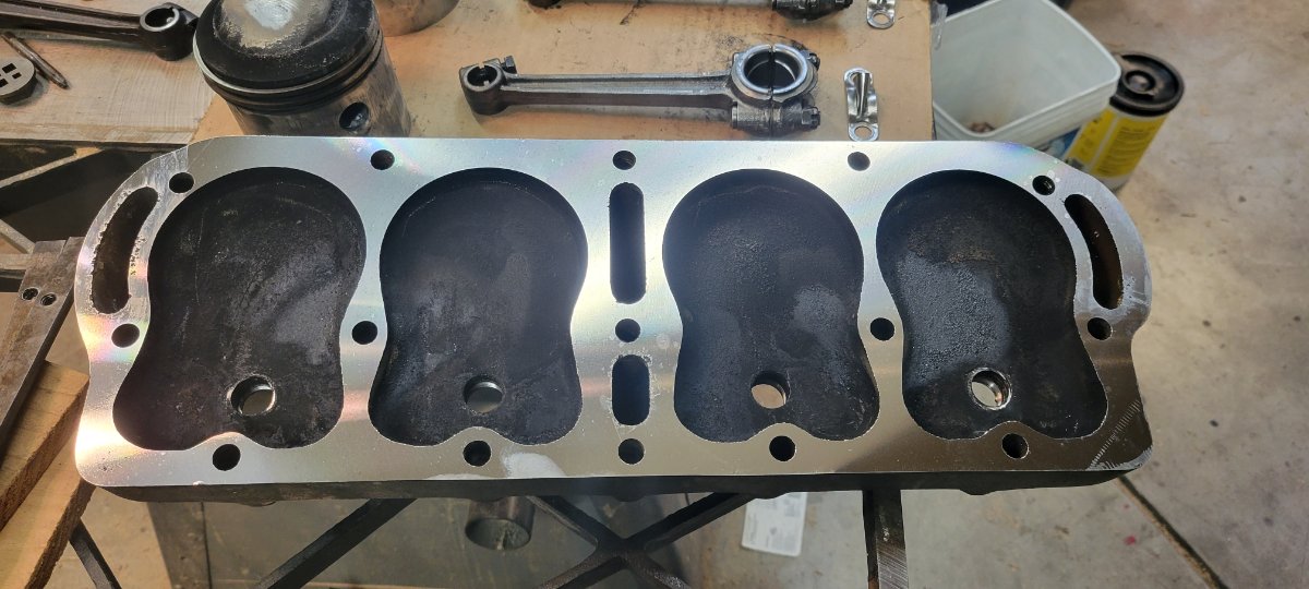

Restoring a Ford Faithful for installation.

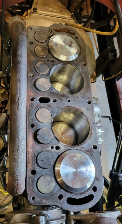

New pistons and rings arrived today!
