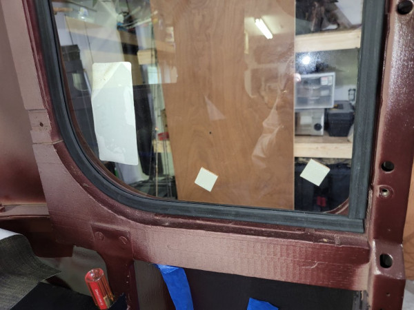

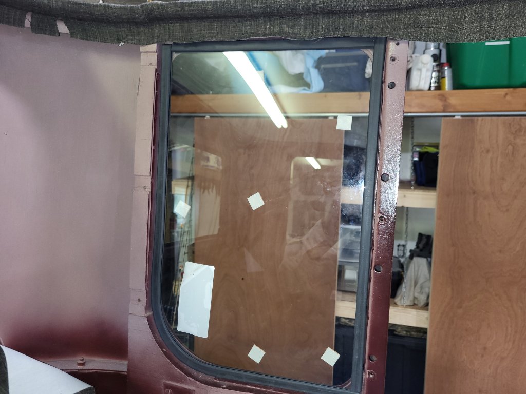

I am getting ready to install the rear and quarter panel windows in my coupe. They will fit firmly into the frames, actually the rear glass is difficult to get into the frame.
My question is: Should I use an adhesive around the perimeter of the glass on the outside?
