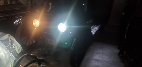

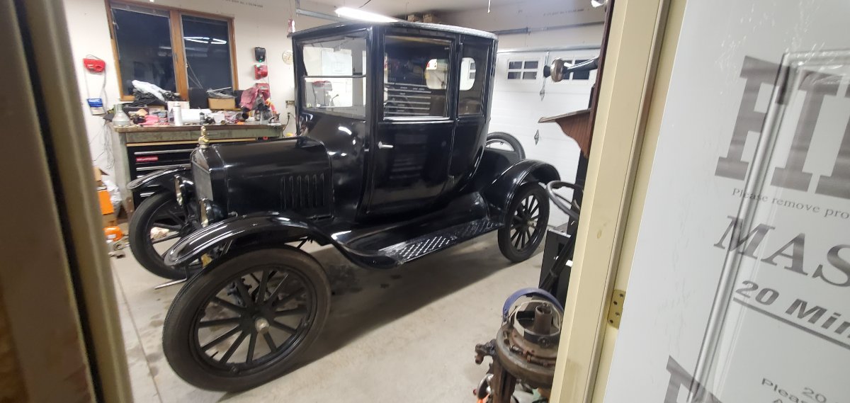

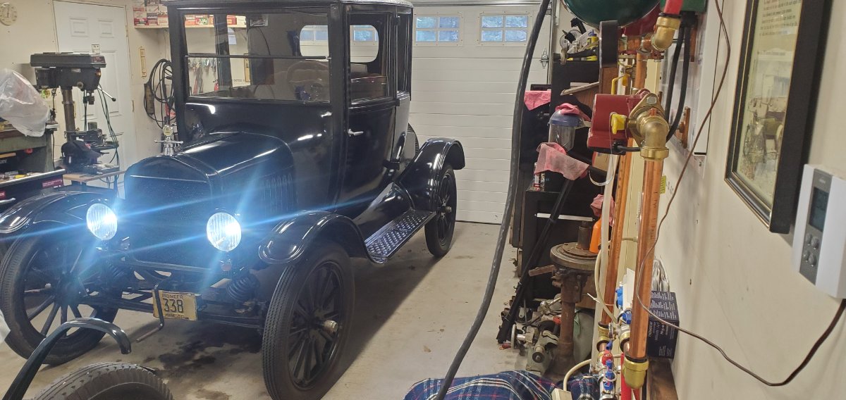

New LED bulbs for Miss Molly, my 23 Coupe
Post by Steve King » Wed Oct 05, 2022 9:25 am

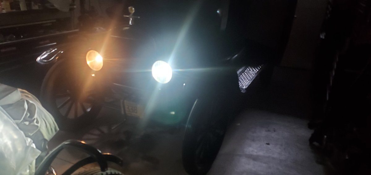

New LED headlight bulb on left versus incandescent on right. 23 coupe with 6 volt not running. Just purchased 2 headlight and 2 tailight bulbs from LEDLIGHT.COM for a total of $56 for the 4 bulbs including the shipping. I have no affiliation with this company. I bought the 6000k bright versus 3000k warm. I know that it doesn't look original, I want them bright as possible. Aiming is another story I can't speak to yet. My experience in my 30 Tudor is LEDS light and reflect the road lines and signs better along with being somewhat brighter. I suppose 12volt would provide higher Lumens. My other experience with incandescent bulbs is, 1 of the filaments of 1 of the bulbs can just about fail every other ride.

I have played with some Led bulbs not happy with any of them bright to look at but don't shine down the road . Yes I have new reflectors also. can't move the bulbs enough to get the focus right.

My darling bride Linda and I came home with the Coupe after dark the other night and she admitted that we could see much better. I will be putting them in my 28 Huckster too.

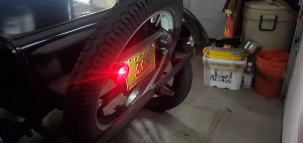

The tailight is much better also.

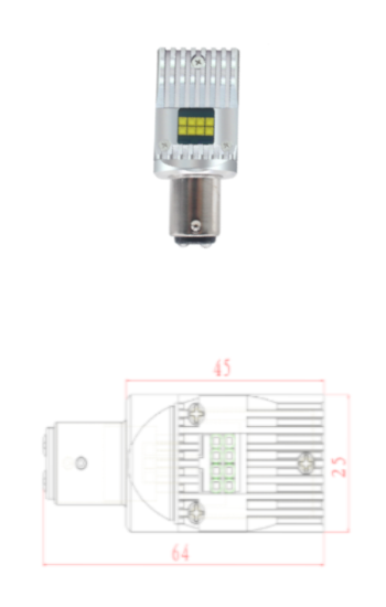

Hey Steve,
Do you have any specific part numbers you can share for the Ledlight.com ones that you purchased?
Thanks!

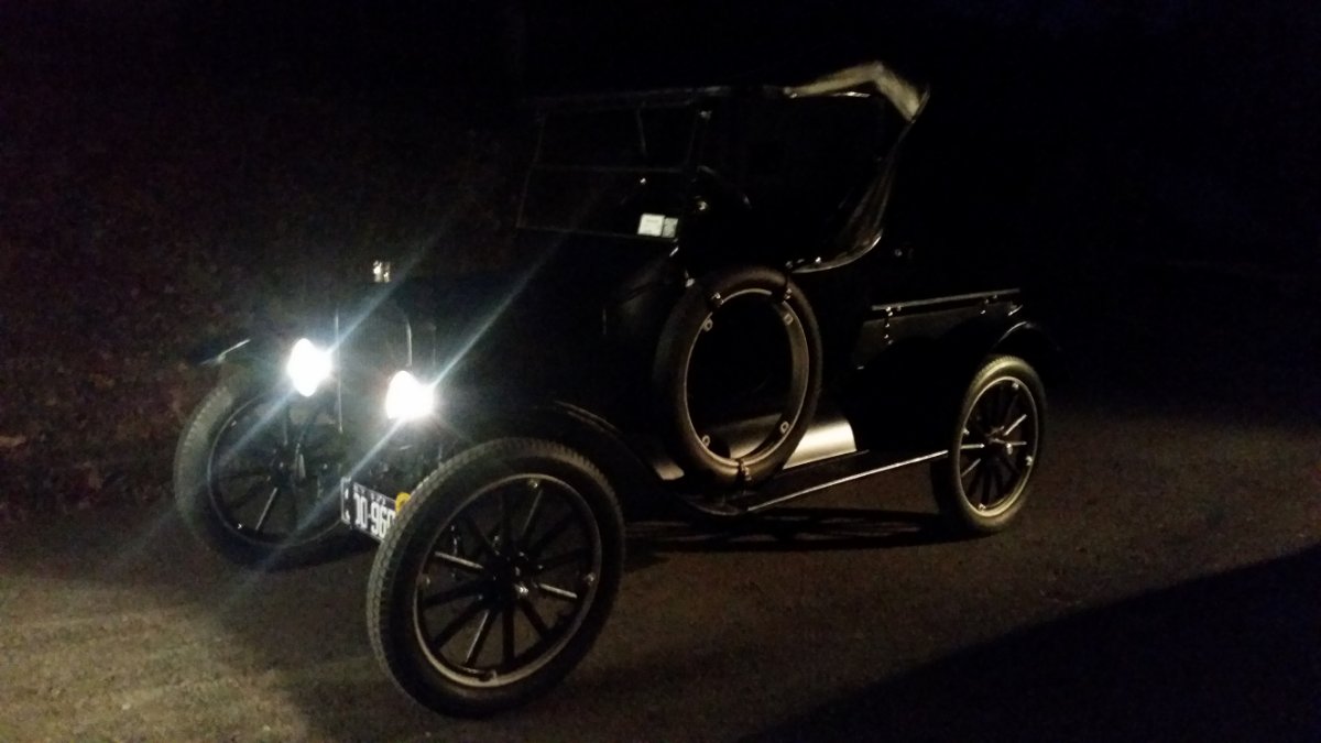

Re: New LED bulbs for Miss Molly, my 23 Coupe
Post by Tim Rogers » Tue Oct 25, 2022 2:23 pm
Those LEDs look pretty good! I guess some folks struggle with the incandescent bulbs, but here's my 6 volt OEMs- nice, brilliant white lights!...

This is what I chose to use 64975 is the part #, they do not do the high low due to the position of the pins so i have them set for a left to right at this time
BAY15D LED Headlightm pn 64975.png (64.32 KiB) Viewed 5896 times
Posts: 6581
Post by TRDxB2 » Tue Oct 25, 2022 4:49 pm
Illuminating the glass lens is not an indication of how much better the road is illuminated. I put led daytime running lights on my daily driver that were so bright they'd hurt your eyes, so I put a smoke film over them. Either way they have little effect in lighting the road ahead for more than 5 feet

Posts: 7279
Post by Allan » Tue Oct 25, 2022 8:10 pm
The last 3 posts tell a story, or not. In the first of the three there is a brilliant patch of white light produced, but no mention of what it looks like to oncoming drivers.
The next tells of no ability to be able to focus/direct the light.
The third, how effective is the light produced for the purpose intended.

I have them in my 15 touring and really like the way they light up. They were easy to install.
Fitz
