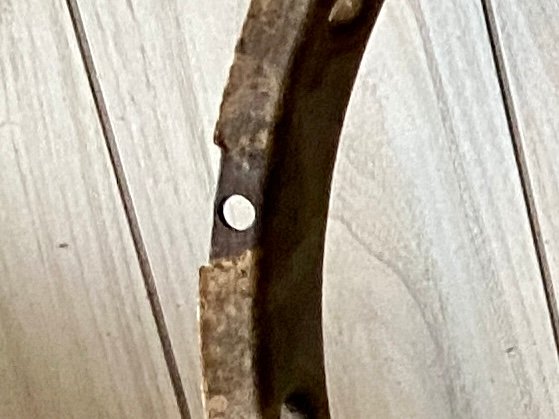

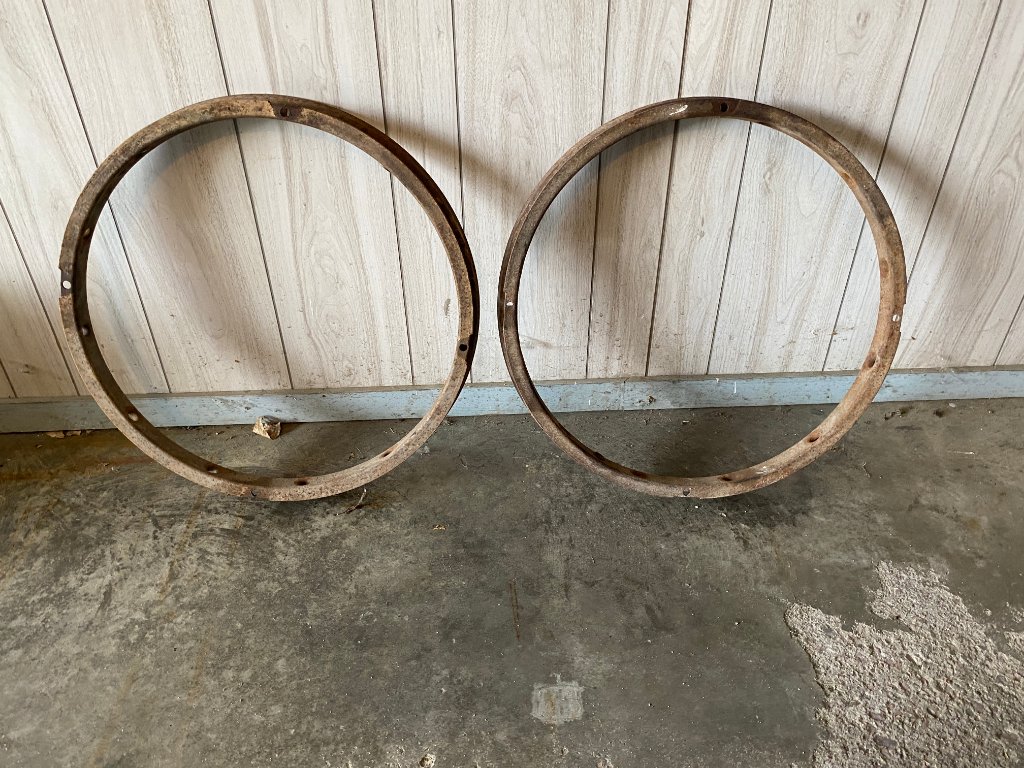

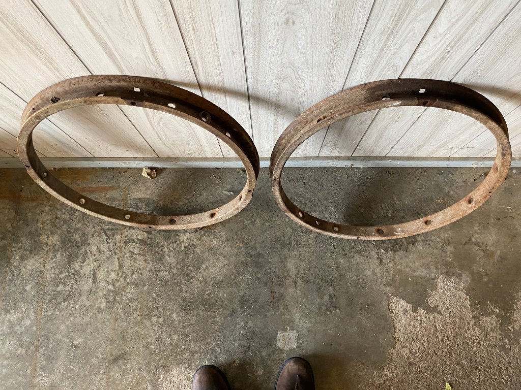

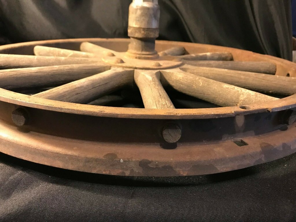

Definitely a novice but learning. I am new to the forum. I have 1924 Model T Touring that I need to replace the rear wheels to match the front. I have 30x3 1/2 demoutable wheels in the front I was able to pick up these two wheels f pictured below for the rear. To get the right rims I'm having trouble identifying if these demountable wheels are a Hayes or Kelsey so I can start looking for the right rims for the wheels. The wheel's are 23" but I don't see any markings to identify the maker.
Question #2 - Can I use split rims with these wheels or better question is there any restrictions to using split rims? I have clincher tires the Wards Riverside. Any input or direction would greatly be appreciated

Is that a cup at the valve stem hole?

If the front has 30 by 3 1/2" tires and those wheels are the same size, then you will need rims to fit the front. Those are clincher tires. They should match so you only need one spare to fit any of the wheels, so you will also need a rim for the spare.

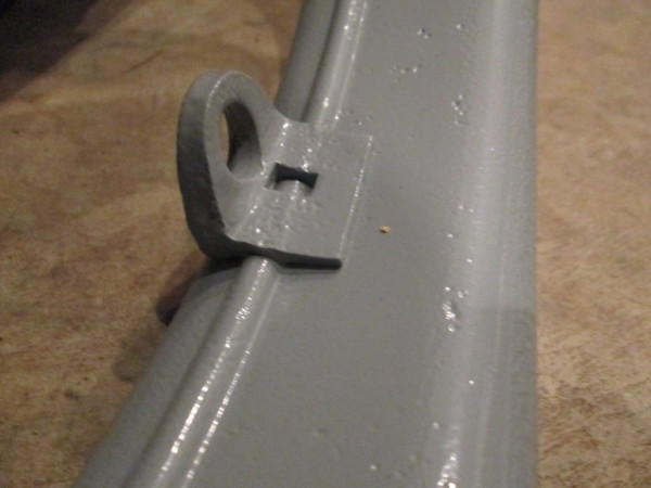

Those felloes appear to be Hayes which require the matching rim with "footed" lug - see photos. Other rims will fit BUT if possible match them up.
- Posts: 7132
Re: 1924 Touring Demountable Wheels and Rims
I agree with Steve. They are likely Hayes rims. The relief in the felloe will take the Hayes rims with the foot on the lug. However, this means they can also take other brand rims with fixed lugs, so any fixed lug rim will suit.
