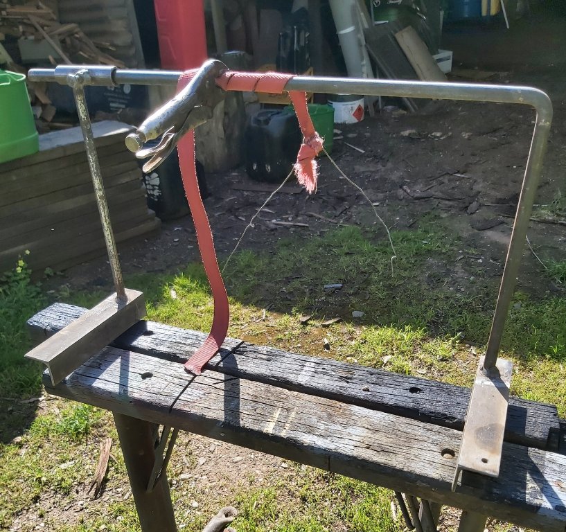

Before we went on the Dubbo national tour, I replaced the transmission bands in the tourer which my son used to take our grandchildren on tour. I wasn't looking forward to re-fitting the heavy cast iron hogshead working through the front doors. At least we had two doors and access from both sides.
I made this tool to help. The angle irons sit on the frame rail. The top rod is adjustable to help with fitting the frame. The red strap is tied to a wire which is looped through the top two holes for the inspection cover.
Working from each side of the car, we dropped the hogshead over the opening and looped the red strap around the rod, clamping it when we had the weight of the cover taken up. That left two pairs of hands yo line up the clutch fork first, and then lowering the cover a bit and re clamping the strap. Then we could line up the band ears and springs before lowering the cover further. Before lowering it to its final position, we removed the cable ties around the band ears.
By not having to support the weight of the cover, we could work at our own pace, and line up things as we went.
All the materials were in the " might be hand someday" pile, so the tool cost nothing.

Great design!! This will be helpful to others.

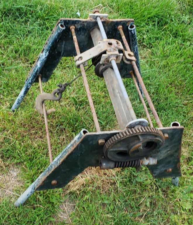

This is what my father in-law used. The wormgear is driven by a 3/8" drive ratchet.

That’s a great idea of using a lift device for a transmission cover. I’ll bet these aren’t the first rigging that’s been used for that purpose. It would make things easier for sure. Maybe others can post a picture of how they did I it.
