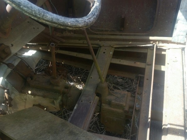

But the chassis I am unsure. Pics of engine and transmissions and diff.

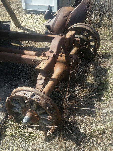

The rear wheels have ford hubcaps. Are they TT? or AA?
Has dual tranys. Like a Ford, but the engine does not look like any T or A stuff I have...

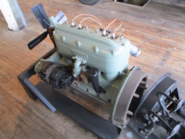

Engine is Dodge, not sure what year.

The rear end and rear portion of the frame is definitely Ford TT, but the front of the frame is not. Maybe they welded a Ford and Dodge frame together in the middle of the car. The body looks like a cut down 26-27 Ford car body, not a Dodge.

The rear portion of the chassis looks like a TT, as does the rear end. The long rear chassis cross member (2 holes on each side) indicates a later model. The front end of the chassis looks like it's something else. Of course the engine is not a T engine.

the aux transmission in there look TT??

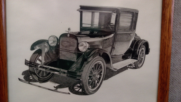

This is a ’24 Dodge Brothers Business Coupe. (This is actually one of my charcoal drawings but I have another photo somewhere if anyone wants to see it. This is a local car that I almost bought.) The body lines are very similar.

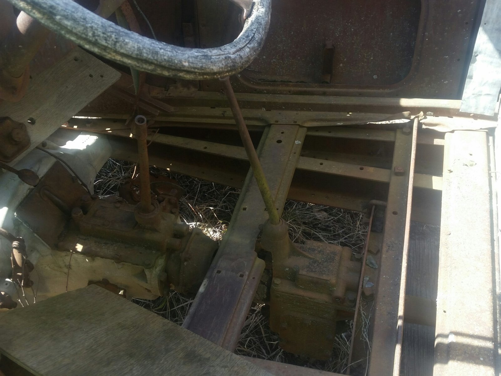

I'm not so sure I'd characterize either transmission as "auxiliary" in the sense of Model T vernacular since neither is tied to a T planetary. The forward one is probably what came with the engine, perhaps Dodge. The second one could be one designed for use in a TT, but it could also be something else. I'm far from enough of an expert to identify it. Maybe someone else can.

defiantly a Dodge Brothers engine and early aluminum transmission … is missing starter / generator unit , but most of the engine components are inplace … always an optimist ...Gene French

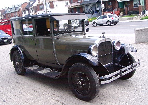

This is a 1926 Dodge Brothers sedan. The body is as close to the yard art as I could find.

The second transmission (auxiliary) sure looks like a cast iron Warford three speed from here. Note the six bolt PTO port on the left side and the Warford transmission mount at the rear. I'm guessing the front portion of a Dodge(?) frame and engine was grafted on to a TT rear section. Dave
