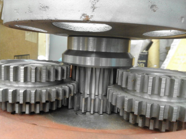

It would be neat to see a picture of these special modified pieces.

Dan McEachern
Posts: 1472
First Name: DAN
Last Name: MCEACHERN
Location: ALAMEDA,CA,USA
Re: Low speed gear
Post by Dan McEachern » Tue Oct 11, 2022 3:32 pm
Here is what Mike is referring to.

Post by speedytinc » Tue Oct 11, 2022 3:54 pm
Thanks Dan M. for the pictures. Its simpler than I imagined.

Post by Art M » Tue Oct 11, 2022 10:52 pm
I am not sure, but this arrangement might result in a reverse gear. I wonder what the gear ratio is
