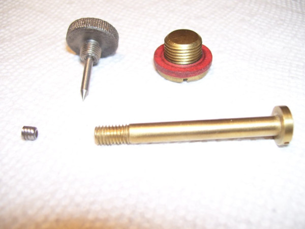

Thank you for all that information. I looked in my box and apparently the spring has sprung, so I will have to find another. Not worried about that. I purchased the carb from Stan 5-7 years ago, but have not installed it until now. It just sat on the shelf. Here is a picture of the parts from the idle circuit. Stan must not have had a ball so he used this grub screw. Since it was loose and it is a screw, I assumed he used a screw that was too small. I will have to look for a spring and a ball to put in there now that you have clarified what it should be. The other two items in the picture are the rest of the idle circuit.
When we had the car running, we turned the idle screw in and out and did not notice any change in the speed of the engine. If the idle screw was turned in all the way, the car ran fine. It ran the same whether it was closed or open 1 and 1/2 turns. The high speed was set at 3 turns. I brought the car home and it was running well. I parked the car and looked at the carb to adjust it and could see fuel at the bottom of the intake port while the car was running. I turned the car off, and pulled the plugs. They were black, so I assumed the carb was running too rich.

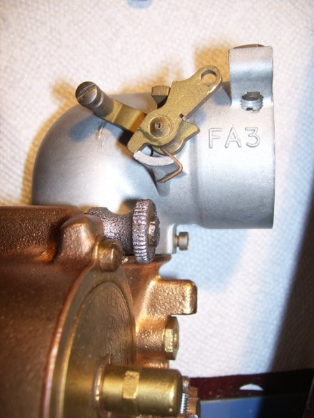

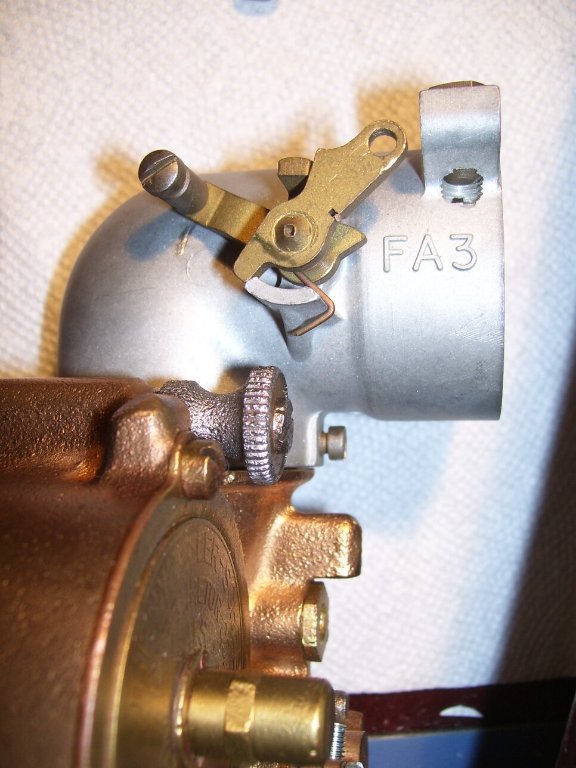

Maybe that means that both my idle speed and high speed are too far open and this particular carb should be set on the lean side. I have only worked with NH's before. A club member stated 'What do you need to go faster for. You already go to fast!'. Here is a photo of the choke extension. I might need a filter on it so dirt does not drop into it. It looks like this carb does not have the enrichening valve, so I do not have to deal with that.
Thank you again for all your help.

Dave; The picture shown is the idle adjusting screw and the main high speed jet with the cover cap. I suggest removing the 1/2' brass fitting that the low speed adjuster screws into and check the small passage that extends under it towards the throttle plate (you can see the other end by looking into the manifold end of the carb). As well, there is much more to the high speed system as the long brass jet shown in the picture screws into another brass cylinder with two tiny tubes inside it. Be careful taking it apart as there should be a very thin fiber gasket under the brass cylinder. Although these carbs will provide more "speed" for your T, the main advantage is a much more precise mixture throughout the RPM and load range making for a smoother running engine, way less carbon build-up and better fuel economy, all without the need for the driver to attempt to make in-car adjustments. When you get it working properly, you will never go back to an NH again, so take your time and fix the small issues. (BTW, you must use a small spring and ball to hold the low speed adjuster from rotating, as the grub screw is not the answer) . As well, rather than add a "filter", try to find the correct heat stove that mounts on the manifold and the flex tubing that connects the carb to it. As with every Model T carb, the heat tube helps in fuel atomization , especially with a cold engine and cooler air temperatures.

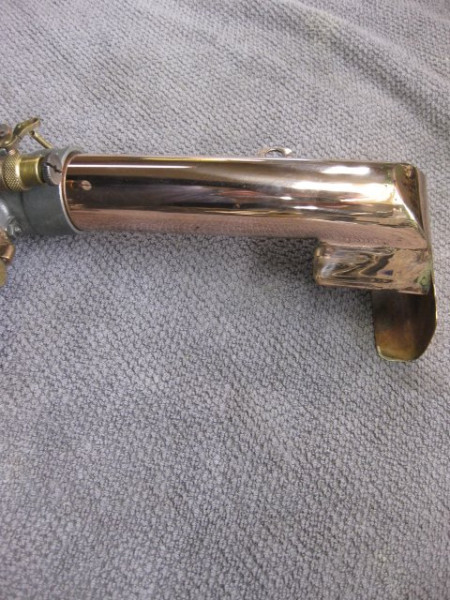

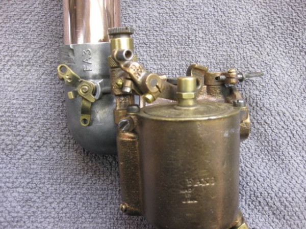

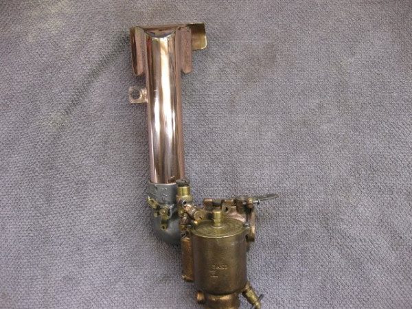

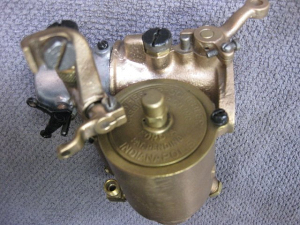

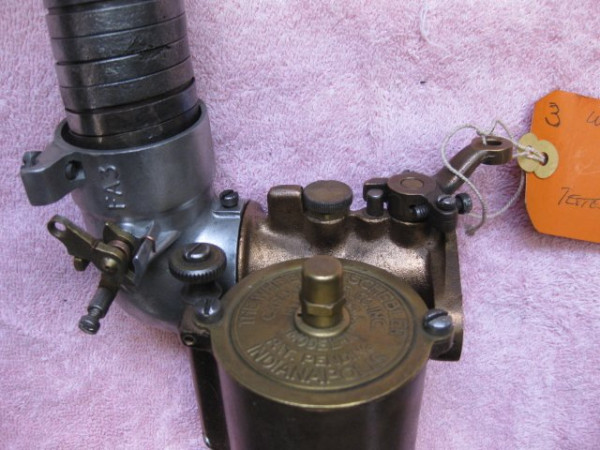

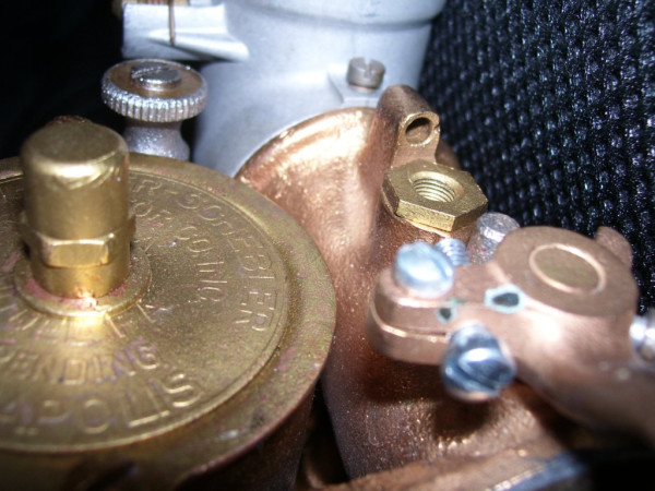

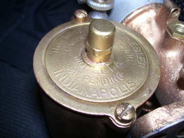

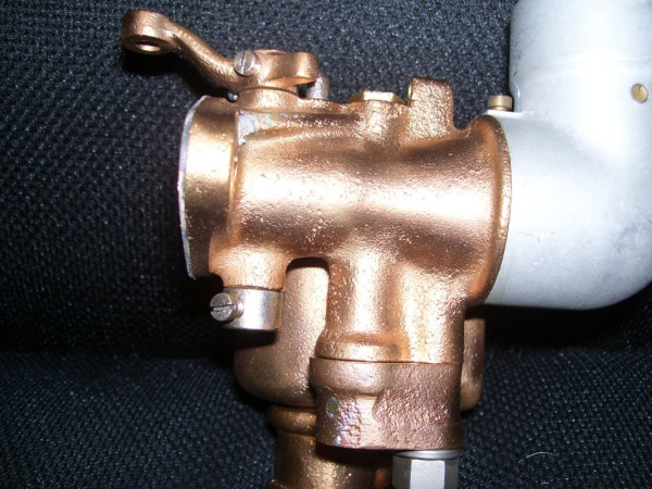

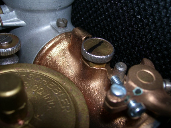

Dave : Here are some pics of the two W-S carb I have, both with the enrichening valve and showing the heat stove I made from copper pipe.It works great but gets really hot and tarnishes quickly.
