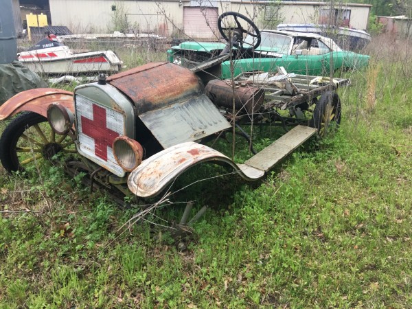

I’m going to be replacing one of the front wheels on my 21 T very soon so I can get it on a trailer and get it home. The current wheel is broken and what’s left if sittijgnin the dirt. I need to go by and take a look at it to see what tools I’ll need but I figured I’d ask here and maybe save myself a trip.
I don’t have any Model T specific tools but have about every other tool known to man. Lol. What tools would you guys suggest taking to make swapping the broken wood wheel out to get my t rolling.

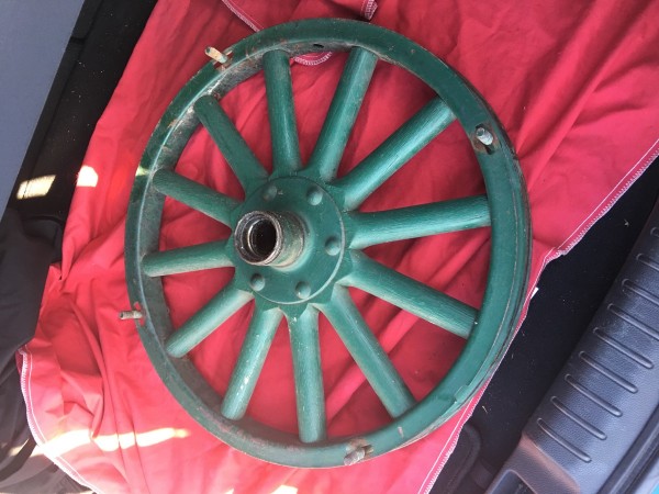

Here is the wheel in question and the replacement wheel. As you can see it won’t roll! Haha

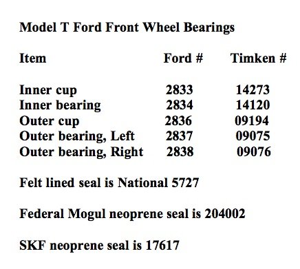

If you need new bearings, now or later, the best prices are usually at Rock Auto, Here are the numbers.

The wheels currently on your "new" T are 23" - the replacement wheel you've posted the photo of appears to be a 21" demountable & looking at the hub, might not be Model T - perhaps Chevrolet ?
And, demountable rim nuts on a car are 5/8" - same as head bolts.

I thought Chevrolet from that era had five rim bolts, while Ford had four? Correct or no?
Even if the Ford wheel is a different size, it should still do the job of rolling the chassis around.

That’s what I’m hopin for. It will get a full new set of wheels or maybe wires one day. This is just a temporary wheel I found for $20 to get it rolling.

That’s awesome. Thank you very much!

Chevrolet also had 4 lug rims as they will bolt onto a 21" T wheel BUT the tube stem hole is not in the correct place.
