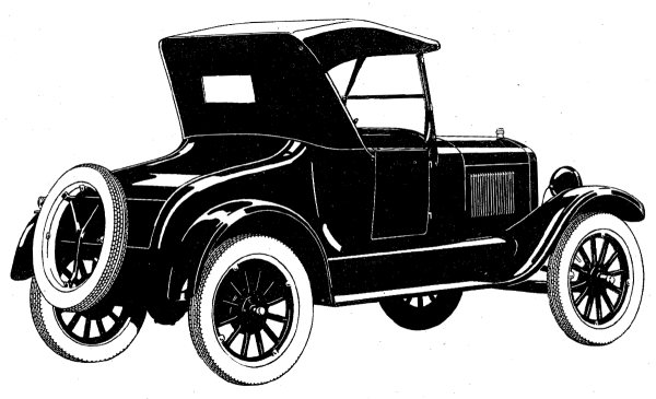

The second is an electrotype for advertising that I found on Cimorelli's website.
Both show 2-3" of slant. My top was installed by an Amish buggy maker who didn't have a clue. My rear panel is vertical, and I hate it.

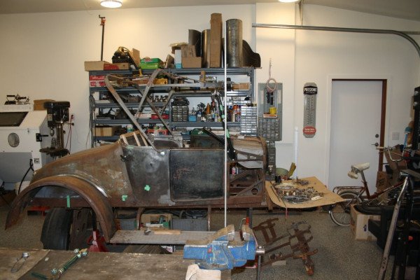

Roof Bows.JPG (55.8 KiB) Viewed 1991 times
I reverse engineered my roadster while building it. I discovered that these cars were designed on a grid with verticals and levels with compass drawn curves. The front bow edge is vertical with the door hinge pins and the rear bow edge is vertical with the forward edge of the rear fender where it meets the sub frame, and the center of the upper deck panel. See the shiny body rib where I sanded it.

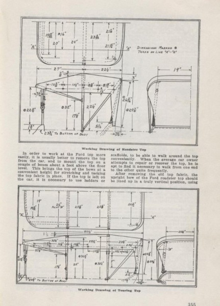

I cannot find a drawing for a 26-27, but this drawing of an earlier model T gives an example of a rear curtain rake. Picture is from a prior posting by unknown party.

The '26-27 top frame and cover is not the same as the one shown above. To OP's original question, 3 1/2" close to what my car measures. NOTE: FIRST POSTING!!!!!!!!!!!!!!!!!!

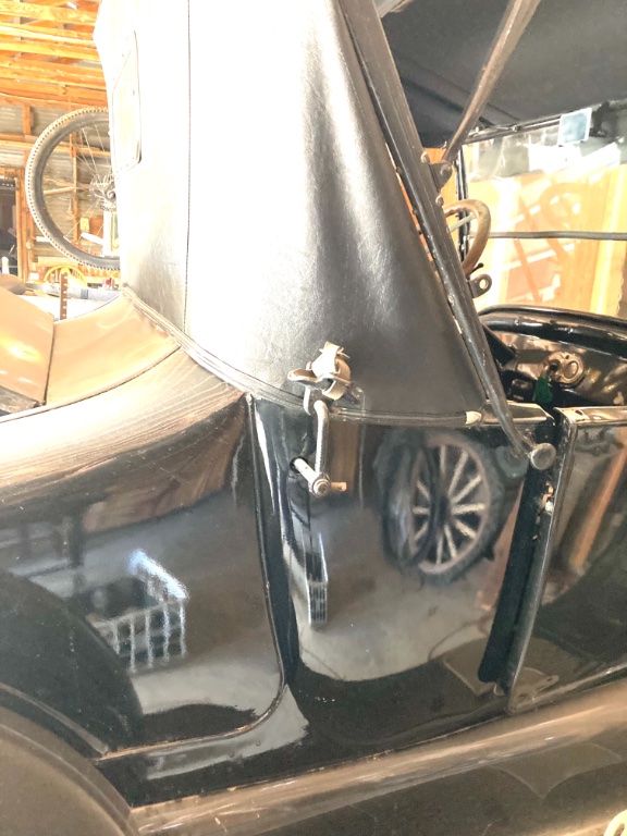

While we’re on the subject of the ‘26-‘27 roadster top, heres another consideration: ... while most of us leave the ‘New and Improved’ top up, some will lower it to the leather covered top saddles. But when this is done your turtledeck access is greatly limited. To solve this I attached the pictured circular metal onto the top saddle bracket with a set screw after welding a 1/2” OD extension onto which the top saddle fastens. This allows for top down + full turtledeck access. 😁
