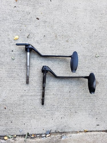

I did this conversion not too long ago and started the discussion in the above referenced link where I supplied some good reference pictures. I wanted to keep my pedal original so tracked down another one in better shape to send in for the mod so here are the two pedals side by side for your reference.
Cheers,
Mike

Post by BLB27 » Thu Oct 20, 2022 2:35 pm
Thanks Mike, that photo shows what I wanted.
