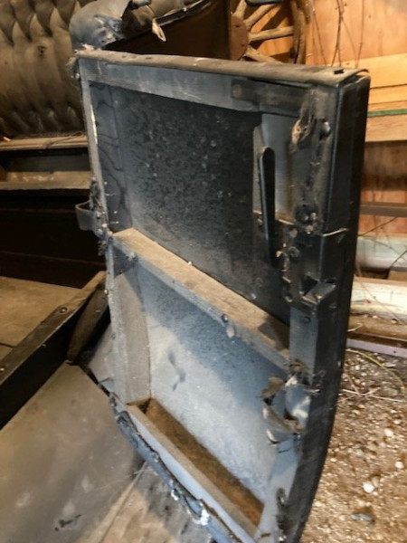

I'm surprised no one has commented on the late 1913 touring body that Langs had at Hershey. I've known about those for years, but have only seen a door. Finally after 60 years here is an example! They seem to be the same door latches used in 1914.

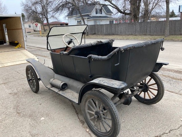

I just sold one of the same. rickd of this group bought it. Maybe he will post pictures.

Here she is rolling out of the trailer at my shop. The wood is in great shape, has the sill reinforcements installed and except for a couple of fenders the sheet metal is good. Original engine 2946xx I'm wrapping up a resto on a 25 Touring and will start on this car next summer.

The car pictured has 14 style latches and handles on the rear doors.

Wayne, after Larry Smith posted about the doors I went into the Encyclopedia version on my computer and re-read his article from 1977, "The Thirteen Model T, as I See It". In the article Larry talks about the 13s built with 14 door latches during the 13-14 transition period you mention in your post. I took his post to mean that the Langs car at Hershey was the first one he has actually seen like that and to this point he has only seen 13 doors at swap meets with the 14 latches.

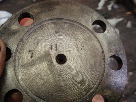

I have #312XXX which indicates a July 17 assembly of the engine.
It is the small door "1914 style" touring body built by Beaudette.
The center section of the rear tub also has a bead along the bottom edge like the '13's.
June 19th block casting and the original transmission which was built on July 11, 1913.
Your transmission is dated but you have to have it apart to see it.

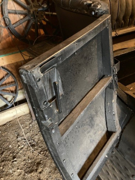

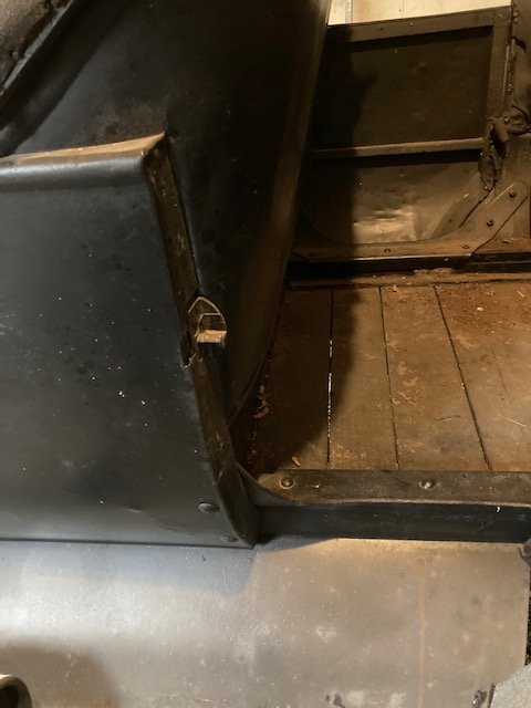

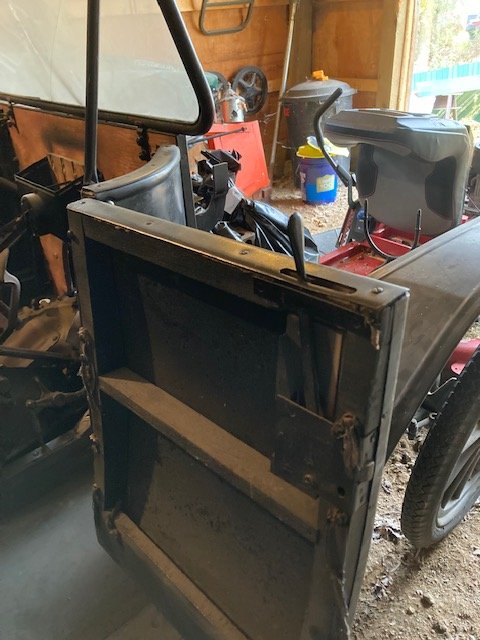

These are the door pictures mentioned in the earlier post. A June 18, 1913 car. Both back doors are 13 doors with 14 latches, the front door has the normal handle. In one of the pics you can also see the sill reinforcement. Its my understanding that the 13s were leaving the factory with the reinforcements during the later body builds.

The body at Hershey was a true 13 body with doors all the way down. It did NOT have the sill reinforcements that were added later in production. I saw it and touched it.Wayne Sheldon wrote: ↑Fri Oct 14, 2022 7:25 pmLate 1913 touring car body? Which version are we talking about?
