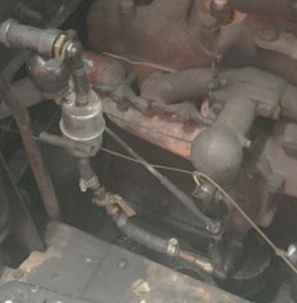

Could some kind soul please post a picture or two of a properly restored 1926-27 Holley Vaporizer? We are attempting to detail such a unit on a car my friend bought and we are unsure of the intake manifold color. The exhaust manifold will go cast iron grey high heat spray, right? But what color is the goofy-looking intake manifold - Ford Engine Green or black? And is the whole thing painted one color?
Also, we are having a HECK of time starting this beast. The coils are buzzing and when in a blue moon the engine does catch and starts, it runs fine. So, I'm ruling out ignition problems. But getting it to the point of starting is an exercise in frustration. There is fresh gas and it is reaching the carburetor. I disassembled the carb portion and cleaned the plate and innards of the intake manifold to remove built-up carbon. Is there supposed to be a gasket on both sides of that plate or only one side? The blown-up drawing showing a Vaporizer does not show a plate gasket at all. But I would assume there must be at least one? This is my first contact with a Holley Hot Snot system and I'm not impressed by the starting or power (lack of).
Can you guys with oodles of Holley Vaporizer experience possibly suggest why we're having such difficulty starting the engine in a warm garage? Lord only knows how difficult it will be to start in the real world outside of a warm garage or in colder weather!

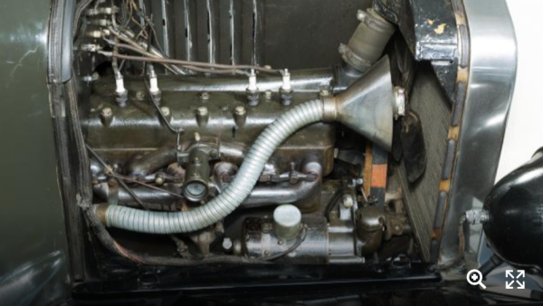

Lots of info & pictures on the vaporizer in t his link https://www.mtfca.com/discus/messages/4 ... 16013.html
This is a picture of the engine in Henry Ford's personnel car see this link
https://www.thehenryford.org/collection ... =gs-559395

Yes, thank you all for your input. I had viewed the suggested thread many times and studied the drawings, as well as other past threads posted on this website. Once again I ask, should there be a gasket on the plate? I don't see such a gasket on the drawing, but there were remains of one in our carb. Maybe there is one (or two?) in the rebuild/gasket kit? If only one gasket, on which side of the plate does it go?
Because the pictured carb system was not a Holley Vaporizer, but a Simmons, I wasn't sure if the intake on the Holley should be green or black. I have seen photos both ways. True, this car we're working on is no Rosenthal Trophy contender, but we'd like to at least get the colors right.
I put a bead of sealant on both side of the plate. The tube inside had had a horrible repair with all kinds of goop at the base. I wonder if there is a leak there? Maybe I should also remove the bulb portion and check the gasket there, too?
