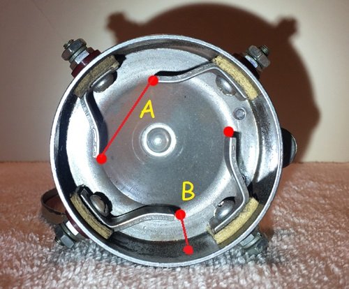

I am in the process of "fine tuning" some Anderson Timers that I own and I need some dimensions.
Look at the image-
A- I need the distance between the point of contact on the terminals where the flapper strikes the terminal.
B- I need the distance between the point of contact on the terminals and the inner rim of the timer case.
Thanks- hopefully, by doing this I can achieve all 4 cylinders firing at the same exact spot on a degree wheel.
Look at the image-

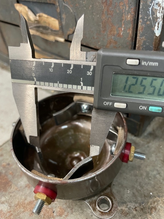

Measured a new rebuild of an original ANCO, rebuilt by Tip Top Timers.
The A distance from top surface across two contacts is 1.255"
The B distance from inner edge of timer shell to top of contact surface is 0.530"
