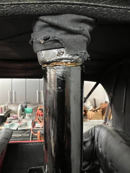

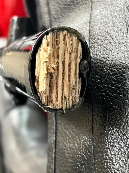

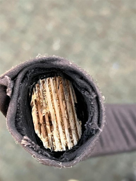

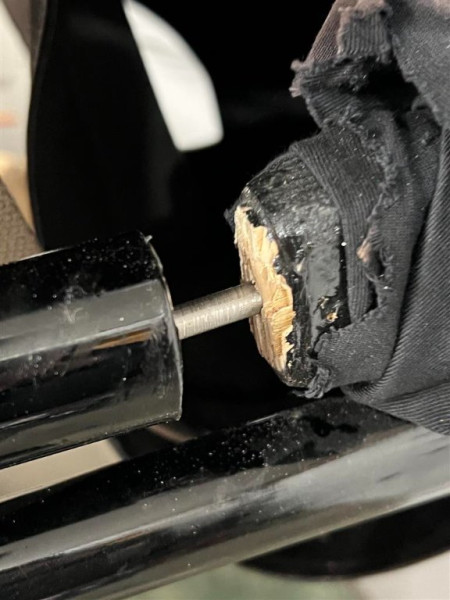

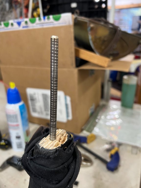

When I restored my '16 Touring in 2008 I installed a new top, new sockets and new laminated top bows.
In about 2012 one side of the rear bow broke right at the socket.
At that time I repaired it by inserting a 1/4" stainless steel rod between the bow and socket.
The rod penetrated about 3" - 4" into each side.
It has held up well.

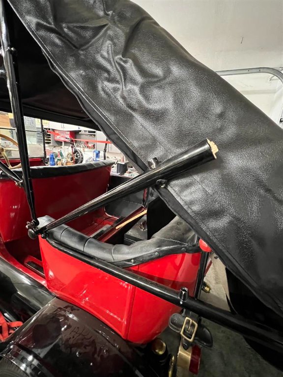

While doing work this last summer I put the top down.
Some time later I noticed that the second bow from the rear was broken at the socket on both sides.

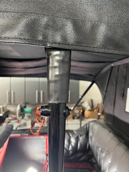

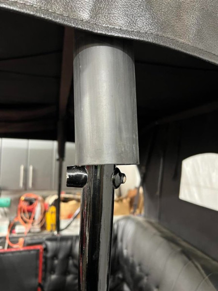

I did not want to go through the hassle of replacing the bow not knowing the availability.
I decided to use the same method to repair this bow.
I made a fixture to match drill the bow and socket.
I drilled the bow to about 3" and the socket to about 4".
The rod was inserted into the bow and the socket.
JB Weld was used as an interface filler between the bow and socket.
I happen to have some large diameter thick wall heavy duty adhesive shrink tube.
Once shrunk, it is about 1/4" thick and very rigid.
The internal adhesive melts to form the the bow and socket.
This should help reduce the flexing between the bow and socket.
Since 2008, three bow to socket interfaces have sheared.
I am beginning to think that laminated bows may not be as rugged as steam bent bows at the bow/socket interface.
I know these repairs will last a long time.
I hope I don't have to do this again.

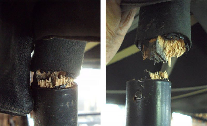

Never in my life have I seen cross-grain laminations in anything other than plywood. I would NEVER have expected a cross-grain lamination to last in this use, ever.
That design is a complete travesty.

Just to be clear, I believe Scott and Rich are saying that the fault in Bob's bow is that the grain of the laminations is running the wrong way.
Think of it like a laminated archery bow. The grain in a laminated archery bow always runs from TIP TO TIP, and in that orientation a bow (archery AND Model T top alike) are very strong. But having the grain run across the long axis is very weak.

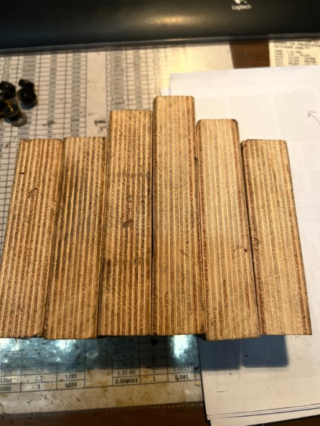

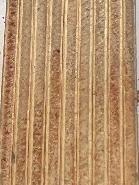

While cleaning up the shop I ran across the pieces of the top bows that I trimmed off.
As you can see they were "laminated" from nine layers of very thin plywood.
