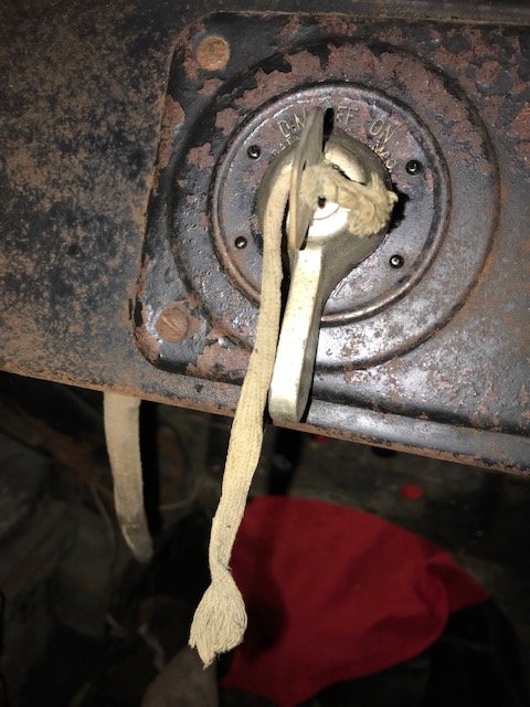

My 1919 Tudor has the keyed switch that appears to be quite standard. The back of the switch says CLUM. The key in the front says Ford. The switch face has DIM OFF ON in large letters around the top and, in smaller letters, BAT on the left and MAG on the right side.
I have an original 1919 Ford Manual. Among other things, it explains how to remove the engine ... but not what to do with the key and the lever underneath it!! I assume either the key or the lever selects DIM OFF or ON and the other then goes to either BAT or MAG but I don't know which does what and I do not want to break anything. Help. Thanks.

The lever is the light switch. either dim or bright. The key turned top to left connects the coils to battery, and the key to the right connects to magneto. Note: If you turn the key to batt to start the car, and have a working magneto, make the switch at idle or fast idle but not when driving the car. If you switch while driving you you will get a backfire and could blow a gasket, or muffler.

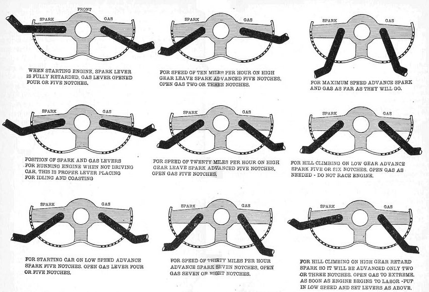

I believe Murray Fahnestock's chart of spark and throttle positions that Jim posted is for driving on BAT. On MAG there are effectively only three or four spark settings. Also, at this point most levers and quadrants are worn enough that you can't count notches anyway.

You may need to make sure your switch is working to begin with and it might BUT after many years the copper contacts inside the switch get tarnished and slightly corroded. A quick way to clean it is to move the key back and forth several times or more to get the contacts fairly clean. It might work. As a matter of fact ALL electrical connections especially the battery connections.

Switches can be problematic but fortunately they can be repaired. As others have mentioned you might want to clean up the contacts and using a volt-ohmmeter to check continuity might help to determine whether things are connecting like they're supposed to. Replacement parts are available including the switch backs although you need to determine whether the back is held in place by pins or clips. Check out Lang's or Snyder's. There is also Ben Martin in Tucker, Georgia, who reconditions switches 770-93 eight- 33 seven-six.

I believe this thread shows what lives inside that switch.
viewtopic.php?f=2&t=18703&p=142381&hilit=clum#p142236
FWIW

I've never found replacement parts for the early type switches - just the later conventional type.

Good thing Rich is checking in. That switch is different than the ones I've dealt with. The advice to clean the contacts, etc., is still good.
