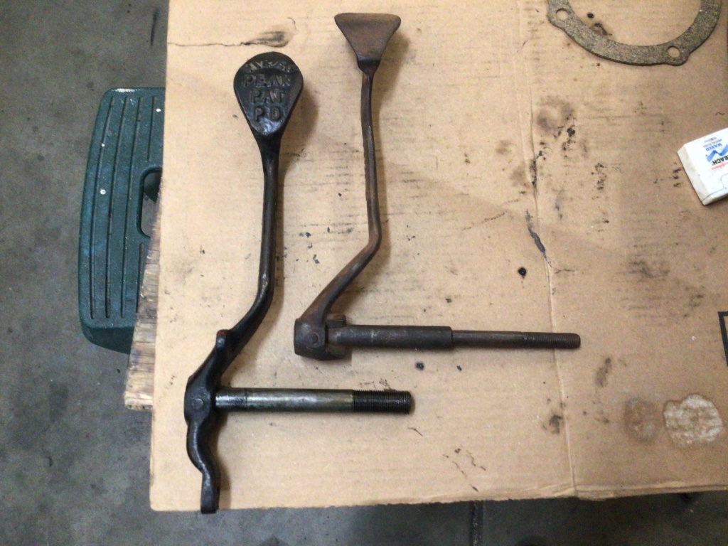

I’m in the process of installing Bennett external brakes. I want to include the drum brake but need to adapt the peddle somehow so it has the cam.
Suggestions are appreciated.
Left picture is the peddle with a short shaft and no cam.
Bob Bente
Redding, Ca.

Weld an arm onto the original Ford brake pedal.
- Posts: 5250
Re: Brake pedal conversion
Yes, that was the normal operation with R/M brake kits. They came with a piece of steel & location instructions for welding.
You can buy a new cast R/M brake pedal with cams.(May not say bennet)
I have seen recently on this forum a pedal like yours where cams from another pedal were crudely arc welded on. (May be in the for sale section)
Either way, you are wise to have/retain your inside brake function with your R/M brakes.
- Posts: 5591
That's appears to be an early, original "Pike's Peak" pedal - I have one of each with no cam. I agree with John about retaining the internal service brake - can't have too many brakes on a Model T !!!

The vendors sell a RM brake pedal with the cam already installed, I have one on my 1924. Be careful installing it, don't drop a pedal spring down into the transmission and then have to fish it out like I did.
