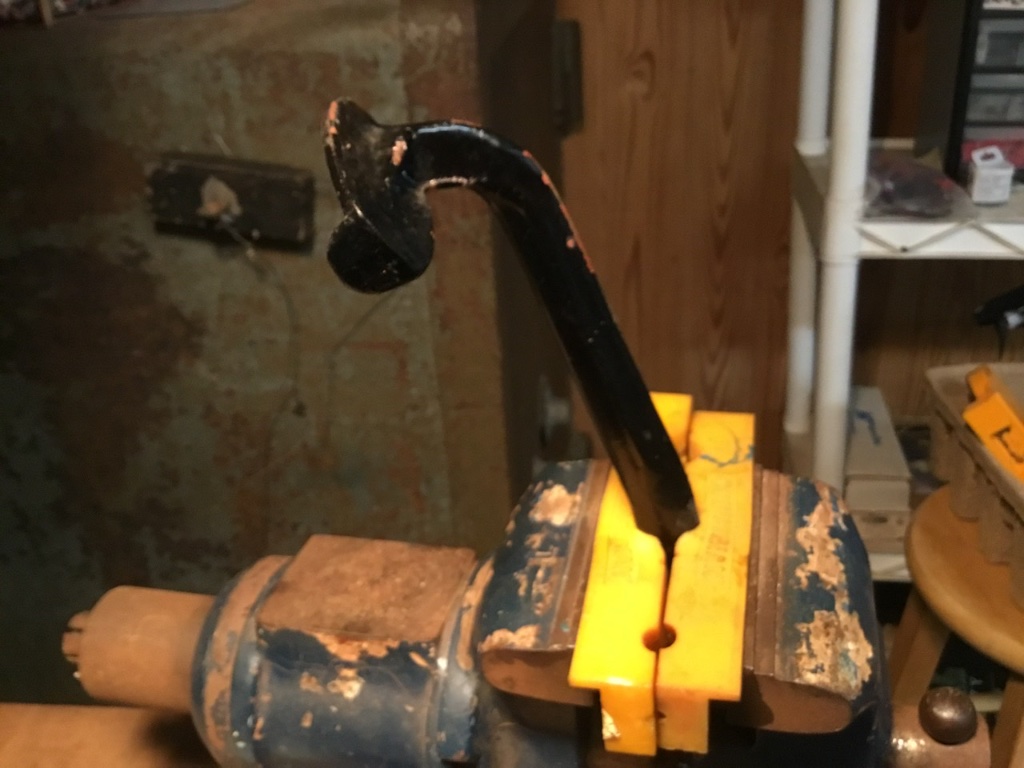

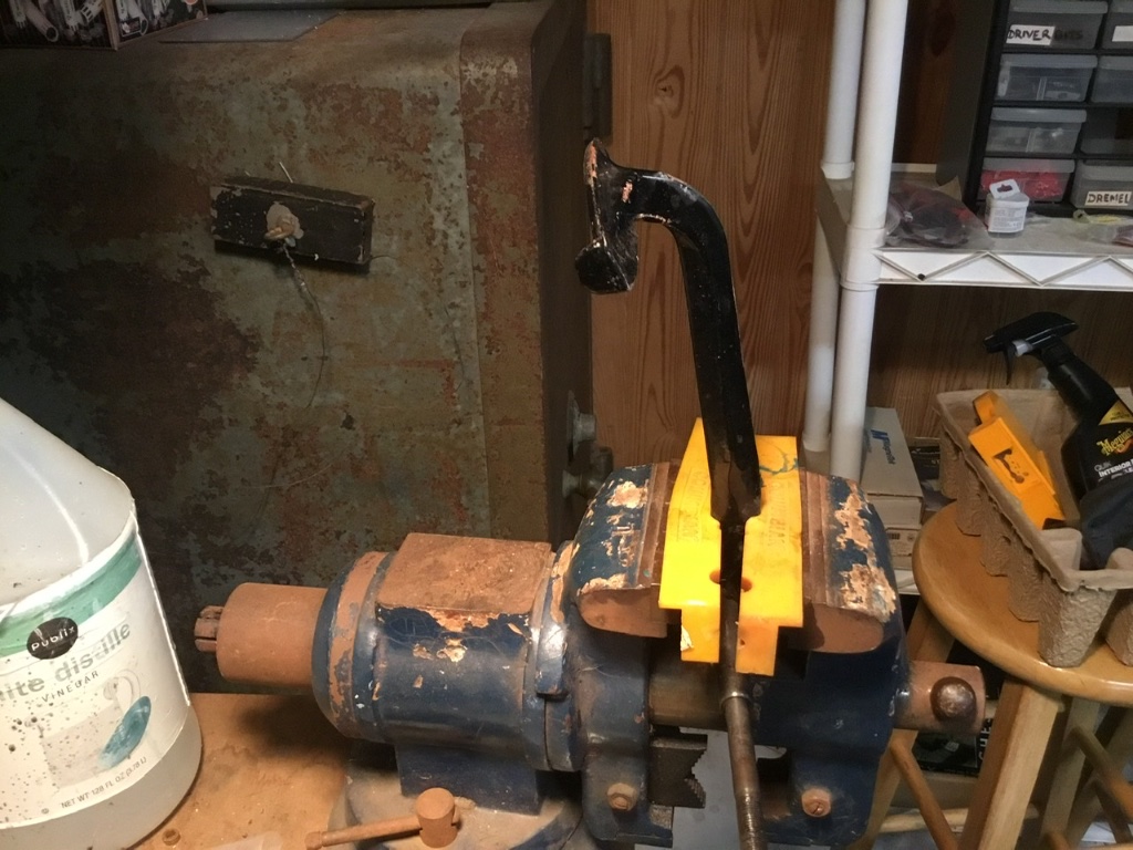

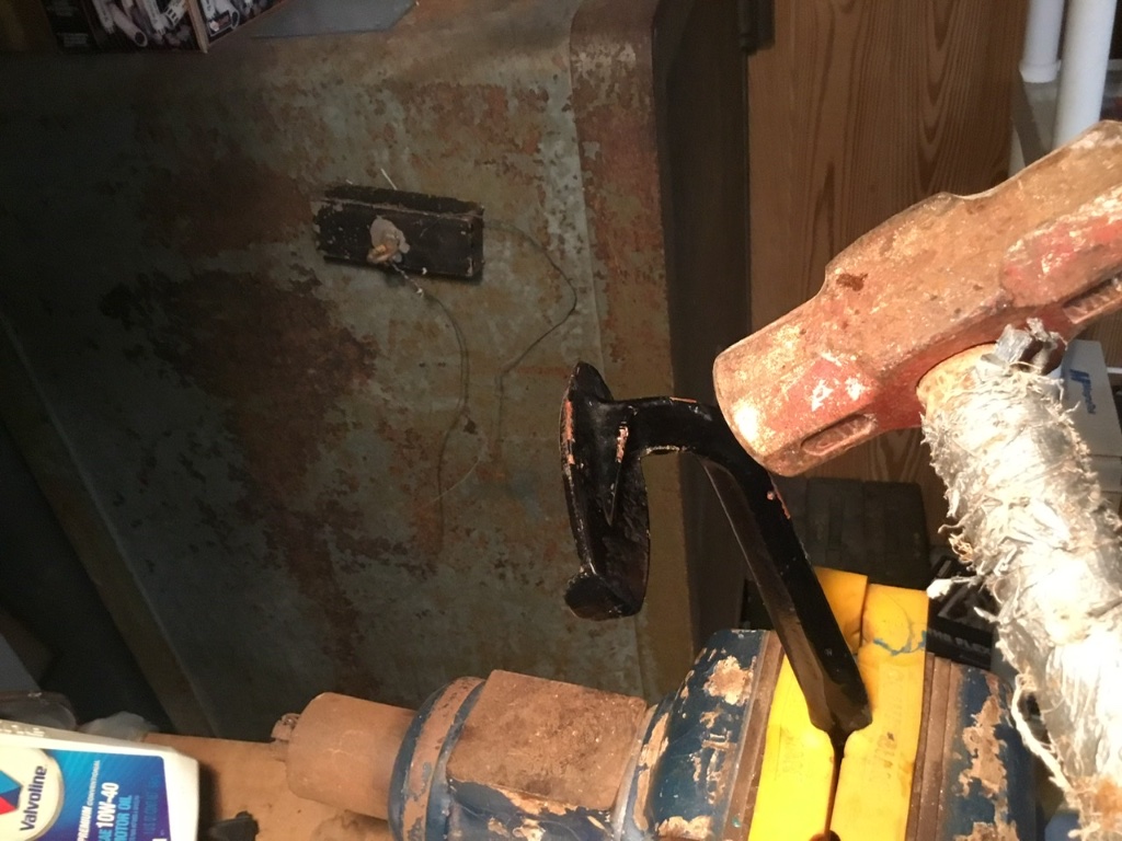

My brake pedal would bottom out on the floor board so I took it off, put it in a vice and hit it several times with a small sledge hammer until the angle was changed enough to give it a 1” space from the floor when fully pressed. I suppose the same could be done with the low speed pedal. Jim Patrick
