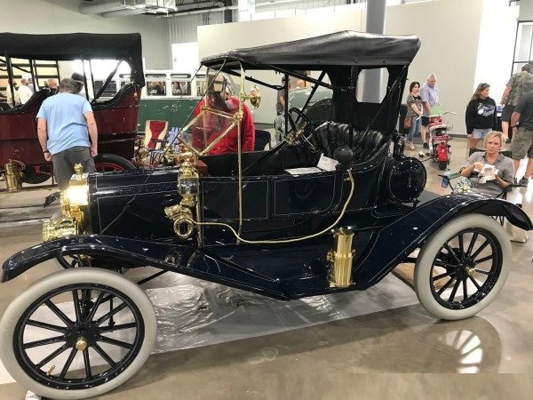

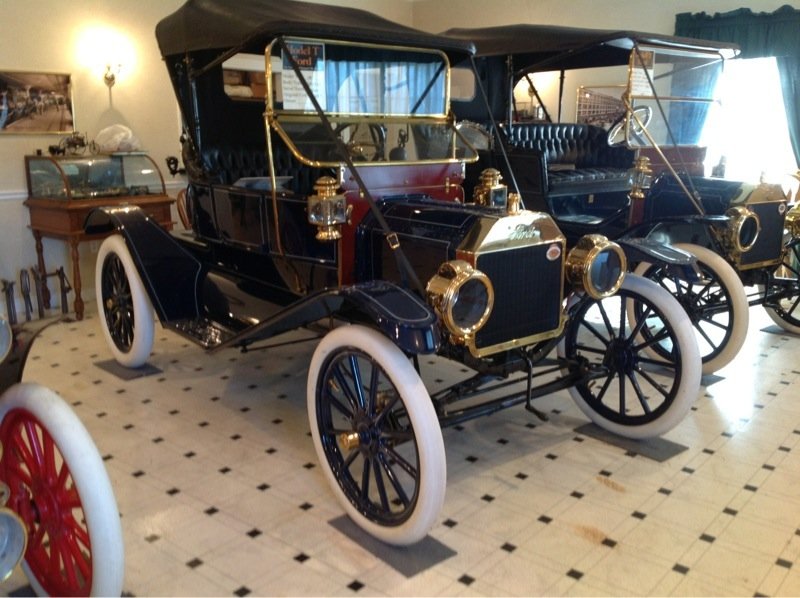

Two local Torpedo's, not mine
Craig Beek's (available $$$) Private Collector - Recent Restoration

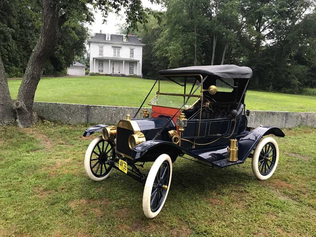

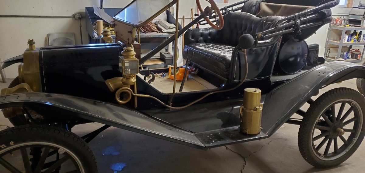

Here is a picture of mine. I have the correct wheels they need new spokes.

Is that car in nuetral in that photo or e-brake on? I'm seeing different torpedos, one is straight up for high gear and the next looks like it's straight up for nuetral like any other.

That cars lever looks to be in "park mode" as it is leaning towards the seat.
On my Torpedo, straight up is actually fully in park, as mine also has RM brakes, and that changes how the lever travels.

E brake is on. Shoes could be worn down it has a lot of miles on them.

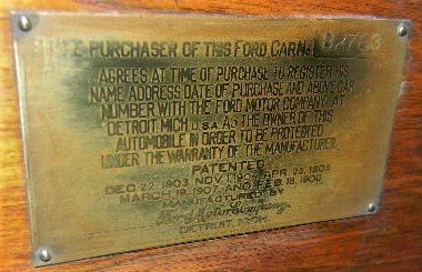

Next question does anyone make the mid year data plate with the serial number in the upper right hand corner?

You are looking for this type?
I don't believe so.

yes that is the one. my car is 789xx

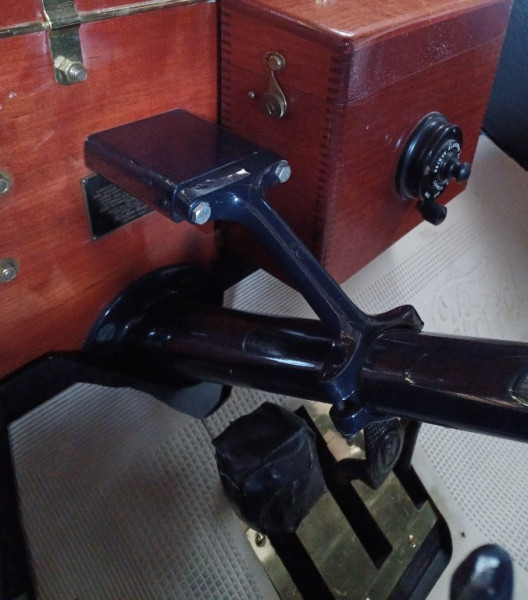

Takes a very special steering shaft bracket due to the column being at a different angle.

Larry...like this one?
Note my hi-tech "pedal extender" for my short legs!
