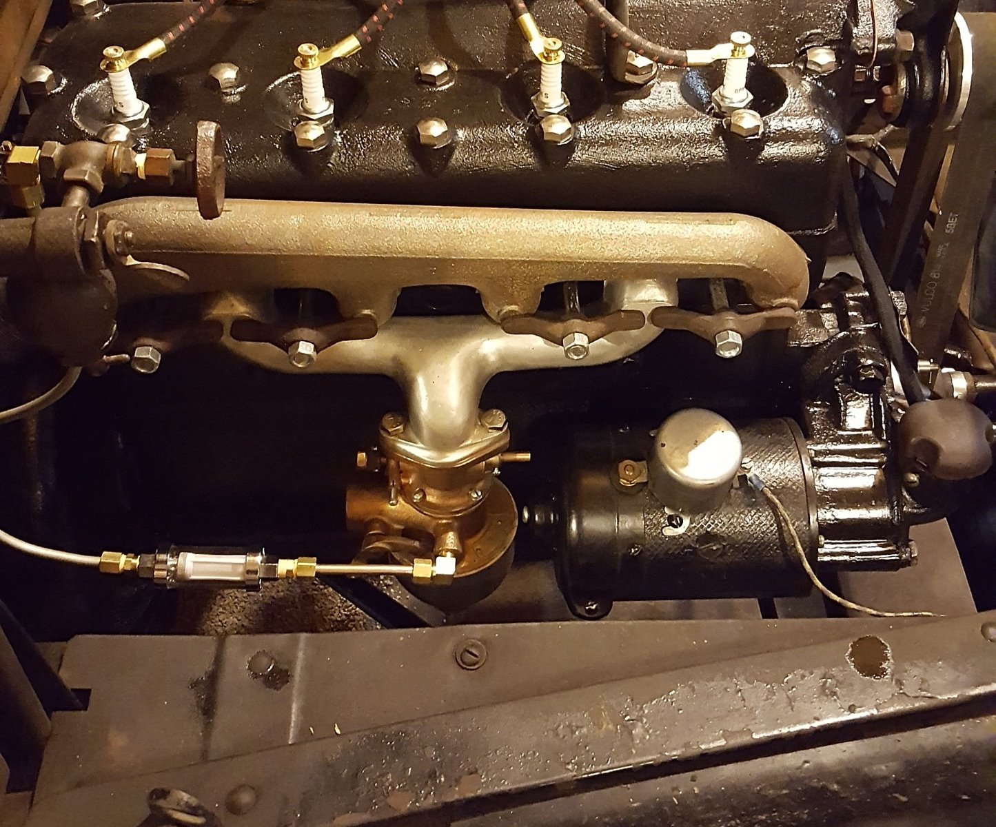

Here is one of Stan's U & J carbs with a straight down manifold on a generator equipped car.
The generator was rebuilt by Ron Patterson and has a sealed bearing so the oiler is not necessary. I plugged the hole with a screw which leaves about 1/8th inch clearance.

Dale,
No problem with the in line fuel filter? I thought the U & J drew a lot of gas. I see how close the straight down manifold sets the carb on a generator equipped engine, but understand the oiler is gone. Interesting. How do you like that carb?

Mark the car runs great. Zoom Zoom as Stan says.
Not ever a hint of fuel starvation with the fuel filter.
