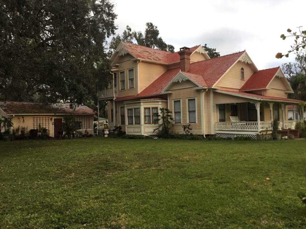

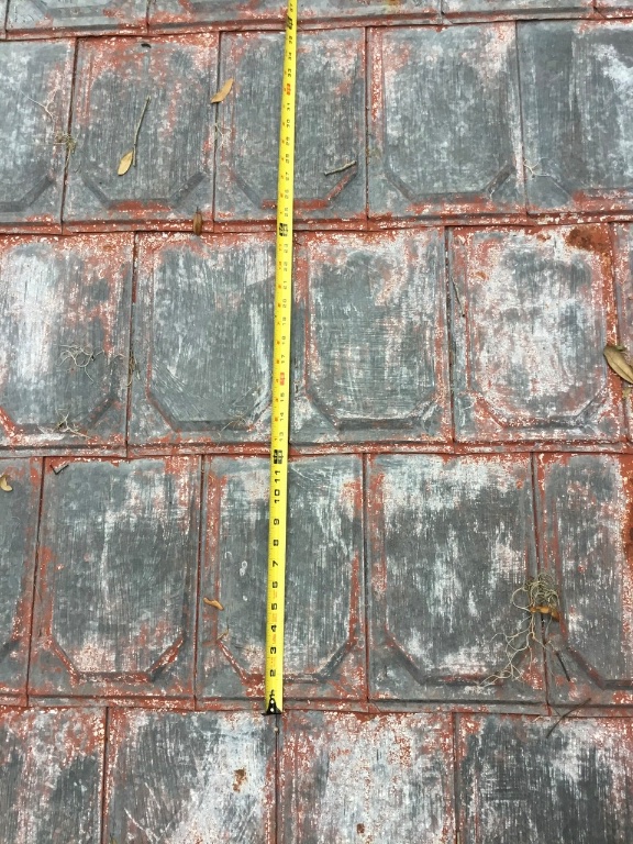

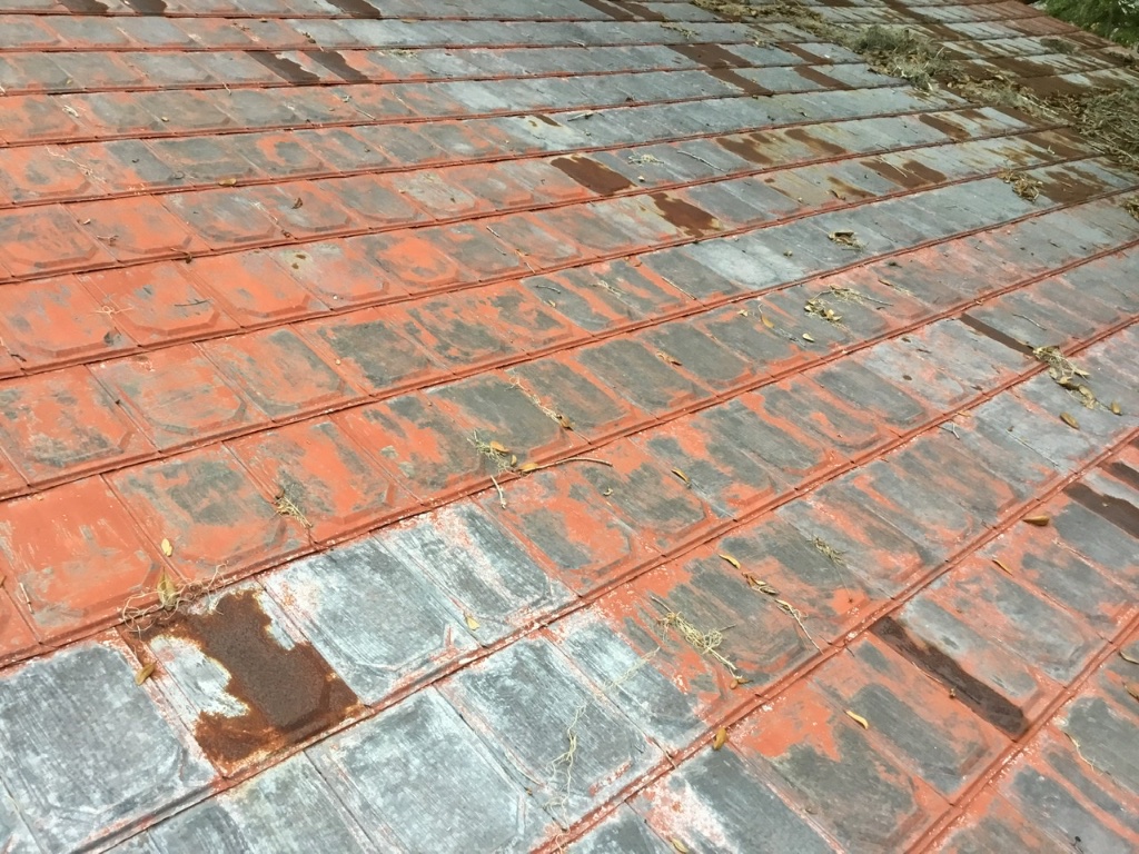

Using Ospho
This is Model T related because Ospho can be used to neutralize rust on a Model T body. Ospho is a phosphoric acid based solution that converts rust to a black inert substance that ceases to deteriorate metal. Some equate the neutralized rust to a protective primer. I have not used Ospho (www.Ospho.com) in a very long time and need to use it to neutralize sections of rust on a metal shingled roof prior to coating it with a rubberized coating. If there is a section of rust surrounded by good metal, and you spray the Ospho on the rust, will the Ospho only treat the rust and not affect the good metal? In other words, after treating the rust and prior to painting, I plan on washing and scrubbing the entire roof with TSP with a long handled brush to remove the old oxidized coating. When washing the roof, will the Ospho wash off of the unrusted metal? The reason I ask is because if the Ospho will not wash off of the unrusted portions, I don’t know how the rubberized coating will adhere to the dried on Ospho. Thanks for your help. Jim Patrick
- Posts: 6801
Re: Using Ospho
Jim
it looks like select shingles have lost their zinc coating allowing rust. For certain the Ospho will aggressively go after the good zinc coating. I use it to turn shiny new bolts/nuts into bare steel by soaking them in a jar of Ospho for about 5 minutes.
Since the rust is quite localized, I'd be inclined to spritz it onto the rusty shingle and then scrub with a scotchbrite pad to keep Ospho contamination off of the good shingles as much as I could. Paper towels blotting the area and then letting it dry should be fine. In high humidity areas such as yours, it will be VERY slow to dry if left on in any quantity and then become sticky where drips congregated. If toweled down to a film, it dries nicely, though you will see whitish powder where it accumulates in crevasses. A clean stiff brush will remove the excess and then primer/paint will stick really well...I do not know about your rubberized coating, though and suggest you test all of this on the ground, on something that is similarly rusted.
When I was in FL, I used gallons of Ospho on various projects and followed their directions and never had a disappointment much less a failure. In the past, I've seen folks on the Forum give advice that was seriously contrary to the products instructions and I never felt the need to have the product fail, when the instructions produce such good results.
Here in WY I have bought the stuff by the gallon both on-line, and at Ace Hardware (hardware stores are still hardware stores here). If you can wait a week for delivery, on-line can be much cheaper.
good luck and be very careful...you have a lovely home BTW.

Thank you Scott. Very helpful. Is it best to brush it on with a paint brush or spray it on? If spraying, what type of sprayer do you recommend that won’t stop up or be attacked by the acid in the Ospho? I have not used Ospho since 1985 and seem to recall that, at first, it went on well with a brush, but as I brushed it on, the brush and surface I was applying it to started to get sticky. After 35 years, or so, is that still the case? Jim Patrick

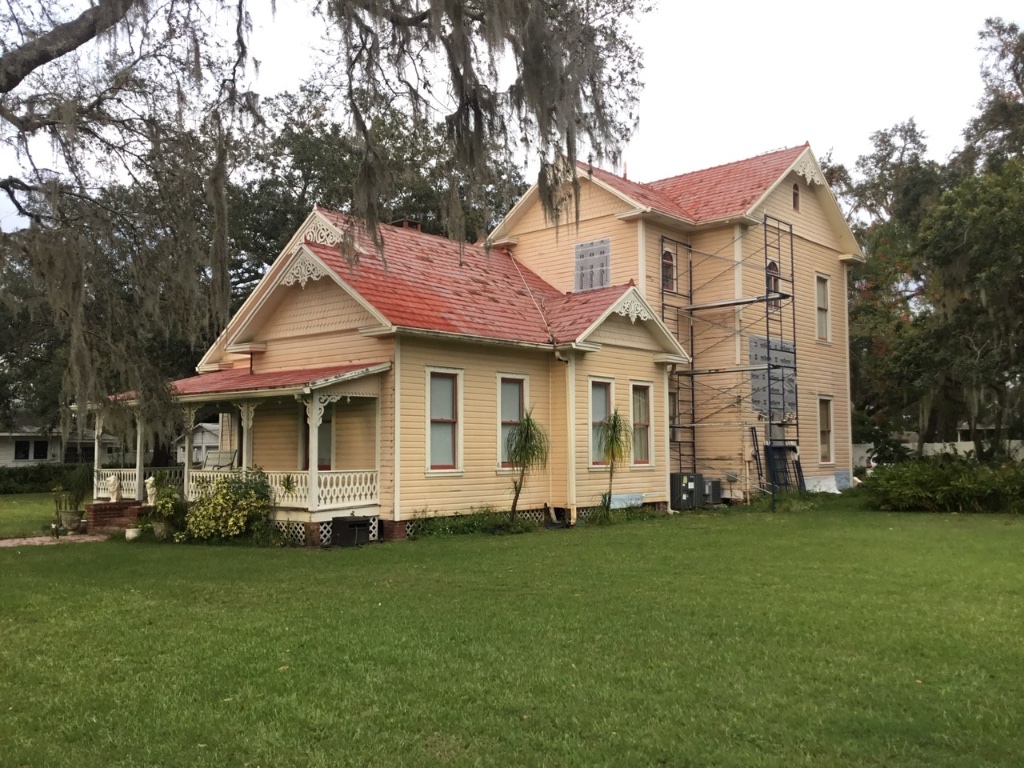

Pat. Absolutely not. Each individual 8” x 12” metal shingle (mfg. by W.F. Norman, www.wfnorman.com) locks into the shingle to its’ left and secured to the roof with two roofing nails on its’ right edge which is covered by the next shingle. Metal shingled roofs which were perfected in the 1800’s, last twice as long (50 years) as traditional fiberglass or asphalt shingles (25 years if your lucky). My roof has weathered 8 direct hits from hurricanes with no damage while every other traditional roof in the neighborhood has been replaced while mine, aside from a little rust, is still going strong. Much easier to coat it than replace it with something less durable. This next coating will last the rest of my life. Jim Patrick

Jim: What would professional roofing companies in your area do to repair/restore your roof? You can't be the only person with this type of roof facing this problem. I would find out and go from there. Gool luck with your project, jb
jiminbartow
Topic author - Posts: 2481
- Last Name: Patrick
- Location: Bartow, FL
Re: Using Ospho
James. None of them want to coat it, they all want to replace the metal shingles with fiberglass at a cost of $20,000.00. Coating it myself will cost half of that and I will end up with a better, more attractive, more durable, historically correct roof for my 19th century house. Since metal shingled roofs, such as mine, are a rarity these days, the roofing contractors don’t have the experience necessary to coat the roof and my roof has such a steep slope (8-12 pitch), and is as slippery as a playground slide, none of them will touch it. Too dangerous I guess. Since I have painted it twice since 1985, I suppose I have as much experience as anyone else, but this time, instead of using an epoxy primer, I plan on using a rubberized roof coating called “Storm Shield”, made specifically for this type of roof, guaranteed for 25 years. Hopefully, if I do it right, and don’t get killed in the process
, this will be the last time I have to do it. Jim Patrick

I wanted to run this by you to see if you think this would be a good list of procedures by which to spot treat the rusted areas of my roof with Ospho, keeping in mind that, with an 8/12 pitch roof is very steep and as slippery as a playground slide, so the procedures must be effective, but simple and kept to a minimum.
1. Scrub the entire roof with a solution of water, bleach and TSP using a long handled scrub brush to remove as much of the old oxidized coating, mold/mildew and dirt, as possible.
2. Coat only the rusted spots with Ospho, by hand, using a 1 1/2” polyester brush, making sure there are no runs and the Ospho is as smooth as possible and keeping the Ospho off of the unrusted areas bordering the rusted spots.
3. Allow to dry for 24 hours.
4. After the Ospho has dried, rinse with water and, using a soft bristled vehicle washing brush, scrub off the powdered residue.
5. When dry, wipe treated areas down with Mineral Spirits.
6. When dry, prime and coat.
Thank you.
Jim Patrick
Thank you.
Jim Patrick
- Posts: 6801
Re: Using Ospho
No, I sure wouldn't rinse with mineral spirits and I would bet your coating doesn't want to see anything which leaves such a film
rinse and dry...yes
mineral spirits...no
please be careful...that whole job gives me the willies...out here we'd use a long reach forklift on huge tires to lift someone up there to work from a platform
rinse and dry...yes
