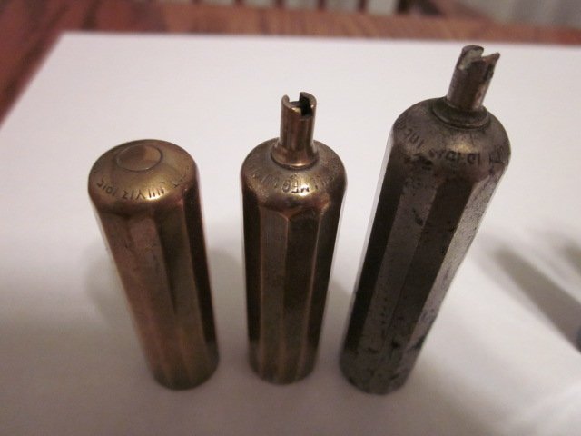

buy a set of vintage DILL covers. They screw onto the thread that the valve stem cap threads onto, and the part that screws onto the stem slides up/down within the dill cover and stays put when tightened down...meaning that a stem that protrudes from 1/2" to 2" will fit inside these: They show up on eBay from time to time and I'd suggest you place a WANT AD in the Forum...you'll easily end up with a matched set of 4 and never worry again about a car with 4 completely different length tube stems...the DILLs will adjust and fit them all

The Dill cover a Scott shows are an excellent alternative.

Taa, if you use the Dill valve/dust covers shown, there is no need to replace the rubber stem!
