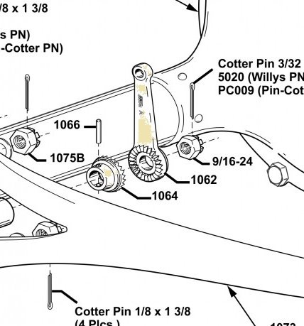

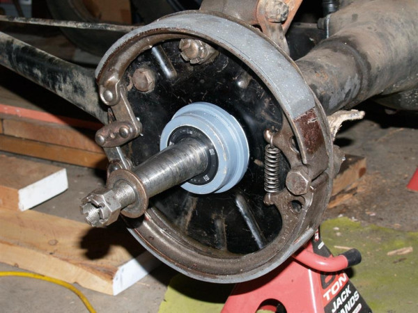

Well, a picture is worth a thousand words. The position of the cam and links is about per this picture. Left and right are the same - i.e. the cam 'leans back' on both sides, and top link angles back as well. When the rod pulls forward it pulls the cam and expands the shoes.
(the grey painted seal carrier is home made - works fine
The lever should be vertical like this: The teeth at the end of the lever allows some adjustment (see Martynn's diagram): https://mtfca.com/phpBB3/app.php/gallery/album/59
YOU MAY BE ABLE to adjust the lever so it 'leans back' a little if your rods are a little too long. Don't lean it back too much or you lose leverage.

If that is YOUR photo, THANK YOU for posting it. I used that exact photo to remedy my problems on the driver's side and check the passenger's side, which I had backwards as well. That leaves just one alternative: Pull the right side wheel, remove the shoes, and grind down the lining a bit.
I have both actuating levers straight up. The throw on the left is more than it is on the right. With all of your help, I believe I am on the right track to successfully install operating parking brakes on this old girl.

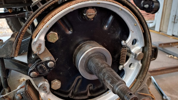

I figured out the problem. The links between the shoes and the cam are stamped/cut steel. Even with the corners clipped off, the link hits inside the cam, during rotation, and will not allow full release.
I thought, at first, the upper shoe was hitting the spring perch nut but it wasn't. Thus, I had to look farther. Moving the actuator lever, it would hit a hard stop in one direction and hit the radius rod in the other. Finally found the spot. I ground the ends of the links round, just taking off the points of the 45 degree angle cuts. Reassembled and everything works great now. Take a close look at Adrian's photo, specifically, the connecting links: They have round ends.
Keep in mind, the top shoe now sits down on the perch nut limiting the release amount. There is plenty of release distance in this configuration. No brake drag noise.
NEXT problem: Now I have to do the same to the opposite side. When I get to that, I will get some photos to show. Then, the future generations will have some photos to look at.
Thank you all once Again!
Terry

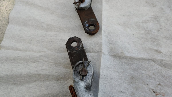

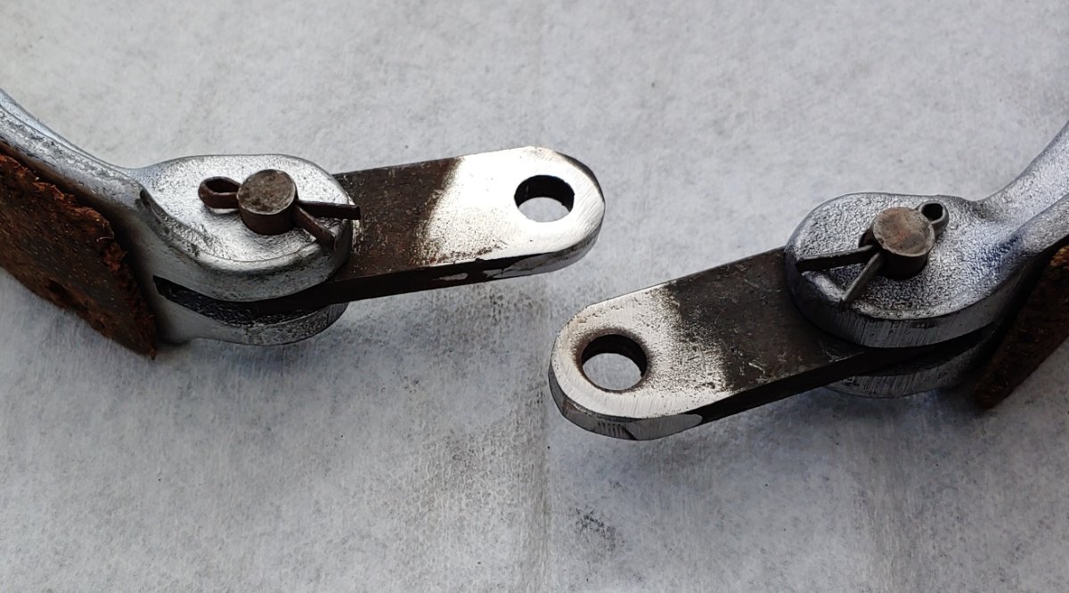

As Promised:
First photo: Brake links AFTER being ground round on the ends.
Second photo: Brake links as supplied with the cut ends.
Third photo: After ground and installed. NOTE: You will be able to see the top shoe sitting down on the spring perch nut. This is as far open and it will ever go without modifying the perch nut.
I hope this will help someone in the future. I know some of you will remember and pass this info on. Thank you for doing so and you have my full permission.
Good Luck,
Terry
Good Luck,
Terry
