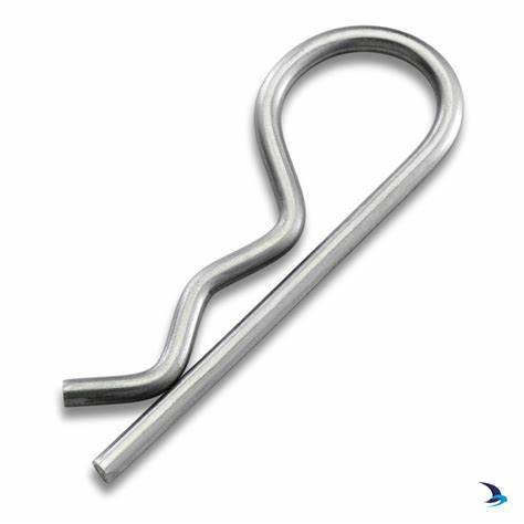

Even a one man top is easier to fold with two men. Most important things are that both sides should be moved at the same time and not twisted when putting up and down. It can be done with one man, but if your paint is good, you risk having one end of the bow slip out and scratch the paint. You need to secure both ends with the clip or at least a large cotter pin before you let go of it, so if you have a person on each side you can use one hand for the bow and the other for the clip. I would recommend that you either leave the top down or leave it parked outside until you can find someone to help you. Even a nearby neighbor might be happy to help you. Especially if you give them a ride.

Norm is correct. You risk scratching the paint when you do it by yourself. It is not easy. I have put the top up from outside the car and I have done it standing in the back seat. Have some retaining pins in your pocket that you have opened up a bit with a pliers or something. Drop them in place and when the top is completely up, switch with the correct pins. Install the middle bow first and then the front bow. Once the top is up, I put the leather straps through the buckles, and use the last hole in the strap. I almost never have my top up. I prefer to drive with it down.
