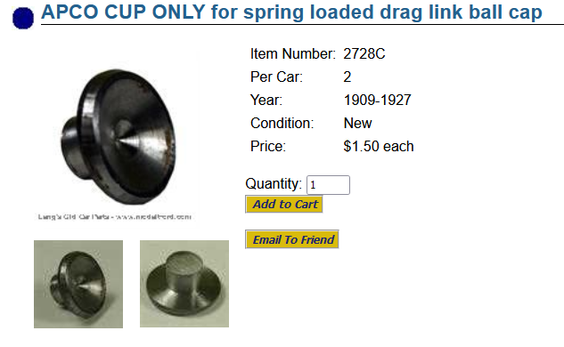

The point of the APCO cap is to remove the play, so it needs adjusting and or the little thrust cap on the spring is worn or missing. Yes, take it apart inspect, clean, adjust, and lube.

_Remove the cotter pin and turn the screw counter clockwise. Best to use a thick washer in the slot (may need to grind down the washer sides)
-My screw won't turn on the car. Should I remove the unit and inspect it?
_Use you must do this! If the screw wouldn't turn like its either in all the way or rusted in place. Some older repro screws were pot metal good ones brass, new repro steel. The disk inside may be worn & or the balls connected to the drag link. Also inspect the opening when attached to the drag link to be round O vs elongated () looking. I grease with disk brake pad grease - its a high pressure water proof silicon that is sticky and will not dilute when it get wet

Ok. I removed the APCO spring loaded ball cap from my 1915 and everything was in there (spring and cup) but the adjusting plug / screw was frozen and wouldn't budge even with a hand impact driver. The other one appears to be fine. A NEW one from Lang's is on the way. Thank's guys. bobt
