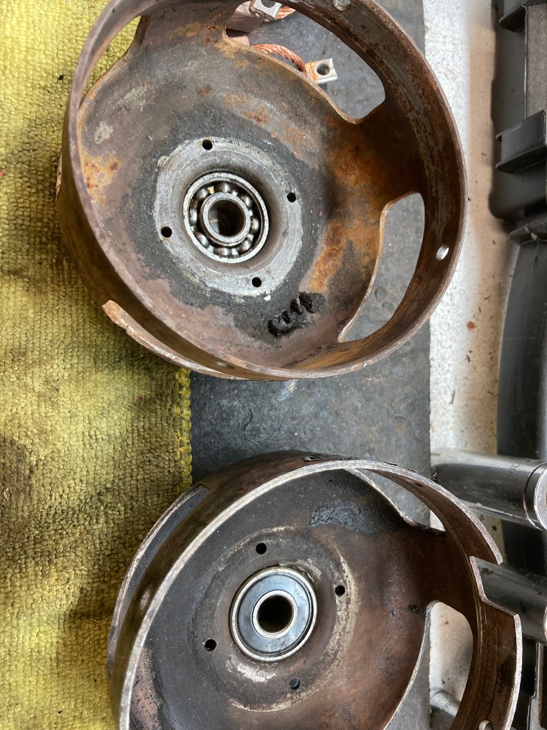

I'm trying to remove stuck bearings from Ford Model T starter and generator end housings. It wouldn't be a big deal, but I now have about 10 of these. I've tried heating them but no luck. There's only about 1/8-3/16" of clearance behind the bearing.
Anyone know of a tool that will remove these short of drilling holes in the back of the housing?

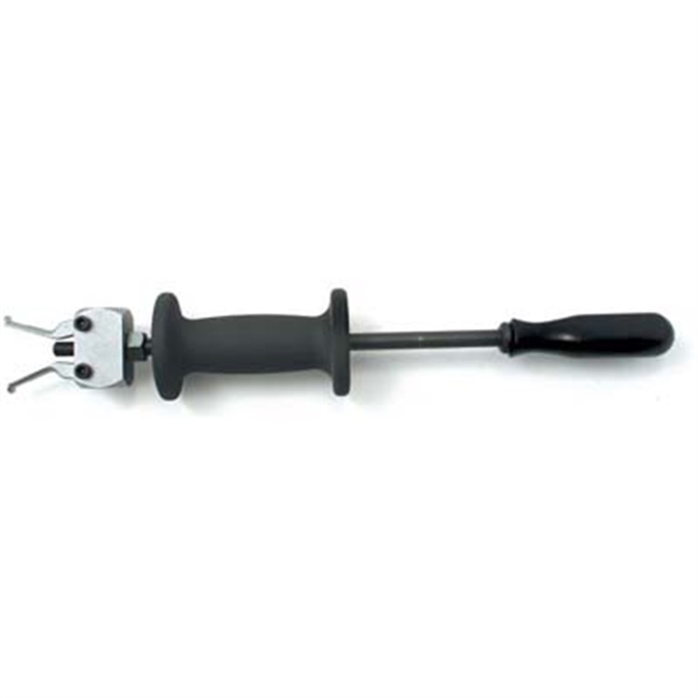

Blind bearings puller. Do it all the time.

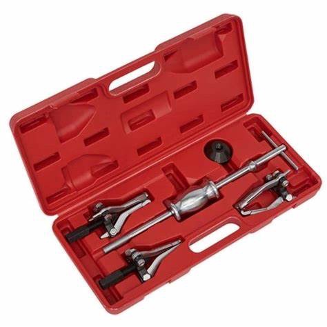

This is called a slide hammer bearing puller. My Dad had one and it worked great. There are the more expensive ones that have numerous ends to fit various sized bearings. For the generator bearing, the spring loaded arms with the outward pointing hooks are squeezed together and inserted into the hole and released. The arms will open outward catching the inside edge of the hole and the bearing is pulled out by forcefully pulling the slide hammer upward and banging against the underside of the handle at the end of the shaft. Jim Patrick
I Have one on order! I'll let you know how it works.

Maybe a little Kroil around the outside of the bearing would aid in easing the bearing out when using the puller. Jim Patrick

As Dan suggested, a blind hole puller will work. So would a pilot bearing puller. As for the grease and a rod to drive in, that works too. I saw a video where the guy used a piece of bread and stuffed it into the cavity and used a hammer and rod. It worked great to, and no greasy mess to clean up.
