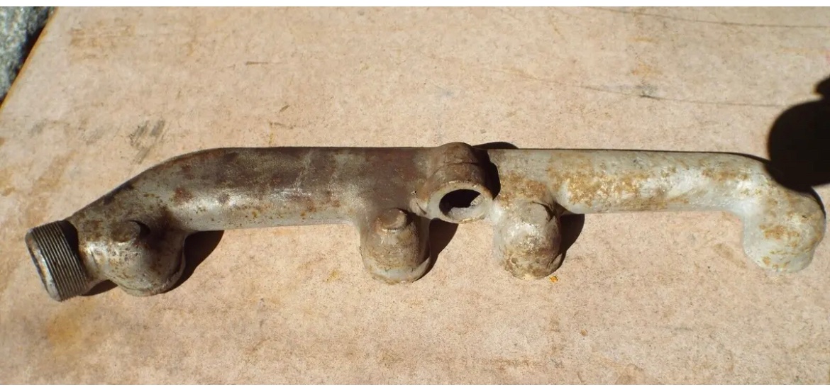

I was gifted this accessory intake manifold that looks like it like it draws hot air in at the top and out at the bottom to preheat, but I think there must be a matching exhaust manifold that Mayes. Does anyone know anything about this one?

Yes, it mates with a special exhaust manifold. The exhaust manifold has a special built in knob that the top of the intake manifold plugs into.
The exhaust manifold is the tough part to find. Maybe someone here happens to have one. The exh manifold has no markings or name on it. The earliest versions of the intake have those 2 "freeze" plugs dated x-x-14.

Looks like it sort of also function as an exhaust cutout that you open ones the engine warms up. I’ll have to keep an eye out for one of those manifolds now.

That’s the right manifold for it on eBay. Somebody added a priming cup to this one,
