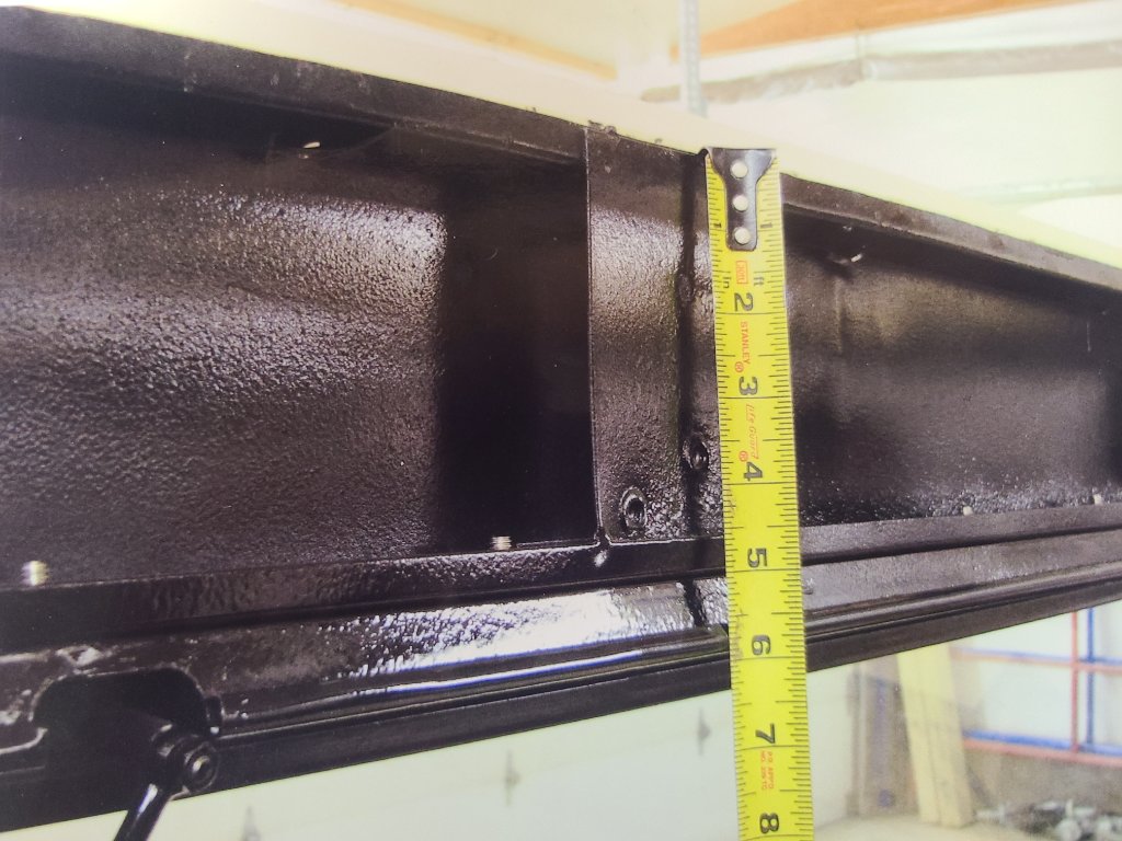

I measured my 1927 Coupe and took some pictures. Looks like about 5.75 inches from the top to the steel edge at the bottom on the side and about 6.1 inches from the top in the middle of the window. Hopefully this helps.

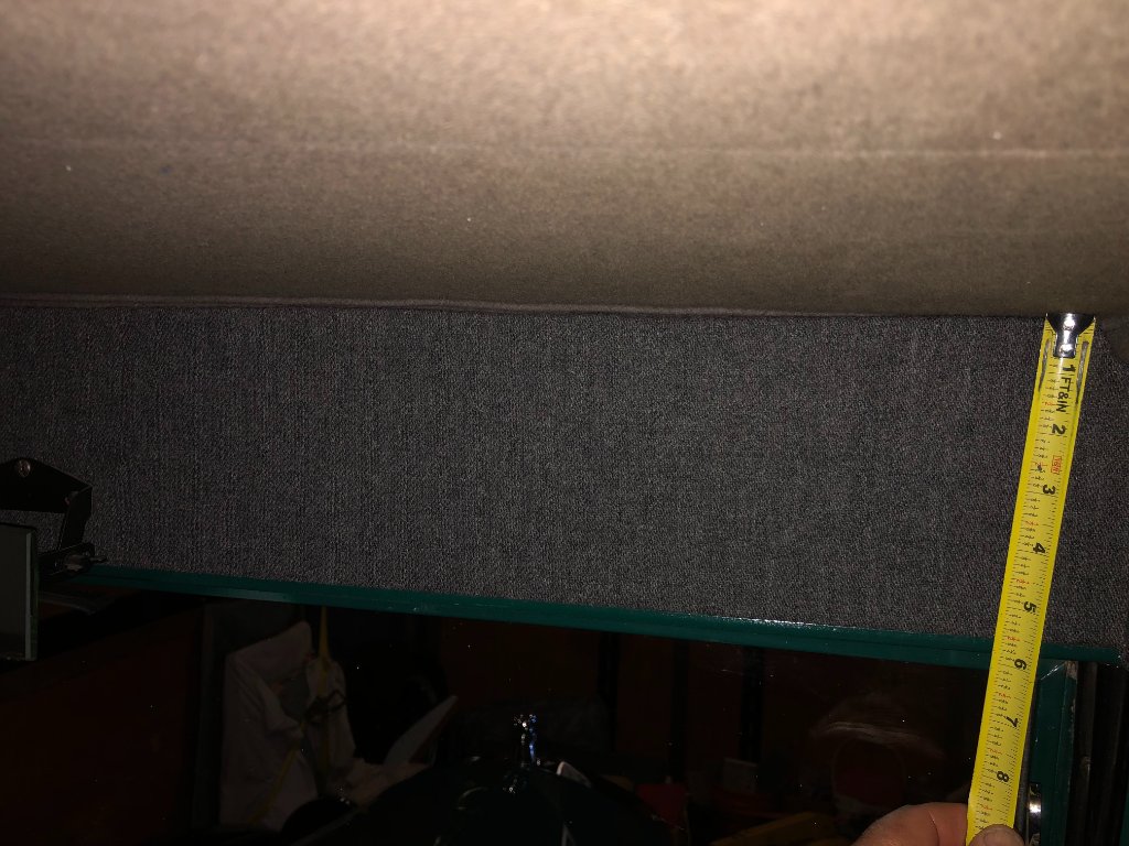

At the top of mine where the vertical panel meets the ceiling, it has a slight curved crown.
The vertical panel is 43 1/4” long. At each end it is 5” high and at the center at the mirror bracket, it is 5 1/2” high. The 1 1/8” wide x 43 1/4” long upholstery strip below the panel appears to be connected to the top of the windshield and is not included in the panel height measurements. If you want to include it with the panel height measurements just add 1 1/8” to the 5” and 5 1/2” measurements. Mine has no cord at the top, but only because no cord came with my “Carter’s Cut & Cover” upholstery kit in 1972. I wish it had. I like the look of the cord. Jim Patrick

The measurement from the center of the bottom screw hole on the mirror to the bottom of the steel edge is 1.75 inches on my 1927 coupe.
