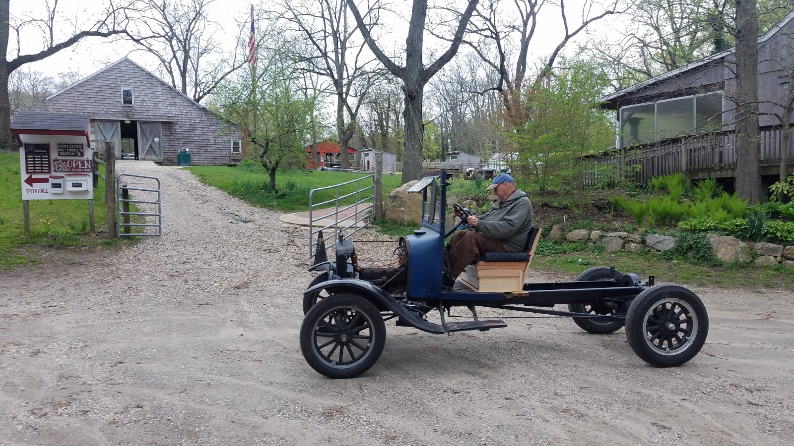

Bob's first ride in his TT
=0]20190428_180337.jpg[/attachment]
