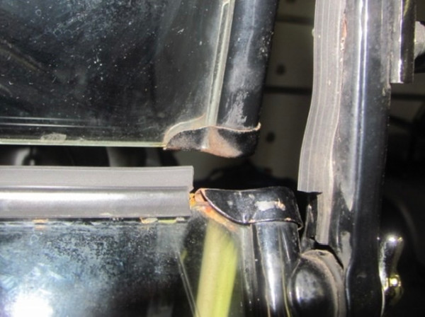

old rubber
old rubber

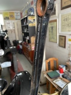

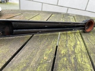

groove of 1923 windshield post

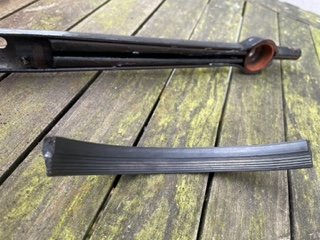

lined side of the new rubber

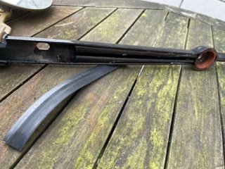

flat side of the new rubber

The seal fits with the more square part into the metal channel, Be sure the channel is fully clean. The rubber strip is started from the bottom of the channel, and is then pulled up, thereby stretching the rubber to ‘shrink’ the thickness, working the rubber in place by pulling it along the channel, that compresses the thick edge as you pull. Sometimes helps to ‘pre-stretch’ the rubber strip, warm it up, fit one end in vise jaws, pull lengthwise, and that can help install. I use silicone paste, Sil-Glide brand on that thick base to ease the hard pull needed to stretch the thick rubber up the channel.
Be sure to cutaway at the end to allow clearance for the mating frame to be closed.

And the lined side of the seal looks to the back of the car.
