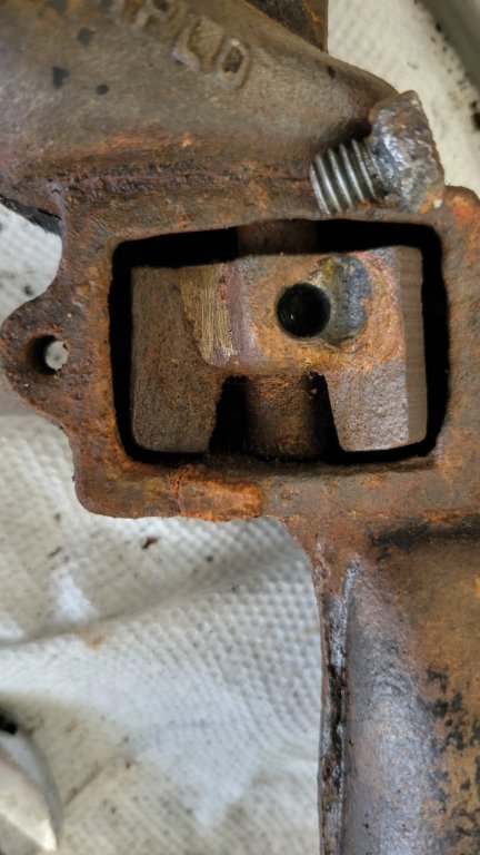

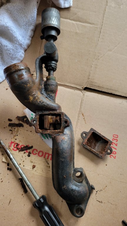

Post by Arbs » Tue Nov 01, 2022 7:44 pm

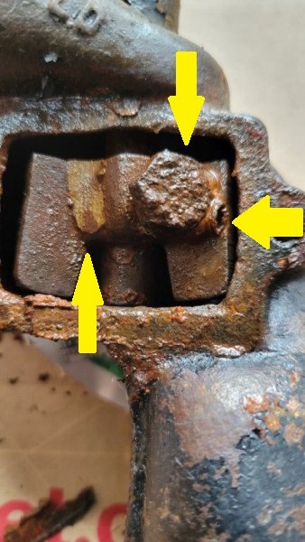

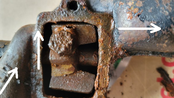

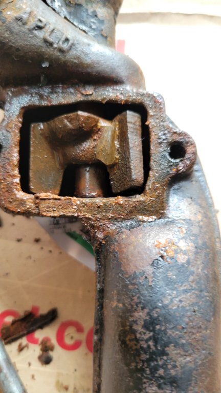

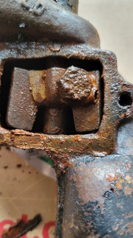

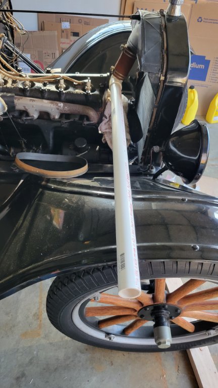

I pulled this water pump off of a T I recently purchased and I have a question. Given the design of this impeller, could it actually pump much water? I didn't expect the angle of the blades to be so parallel with the water flow. I'm not asking if water pumps are worth it as that has been rehashed many times. I'm just curious if this one would even work.

Post by TXGOAT2 » Tue Nov 01, 2022 7:58 pm
It would move some water, at least at higher speeds. Is the impeller as designed, or has it been repaired? From what I've seen, the T accessory pumps were not designed to be high volume pumps. The small diameter of the impellers, and inefficient volute design would only give a gentle flow. That was all that was needed or desired in a system with no thermostat, no pressure cap, and capable of operating on thermosyphon. A high volume pump would consume more power and would force water out the overflow pipe at higher speeds. A high volume, rope packed pump would also tend to suck air in at the shaft seal at higher speeds. A pump with excess volume capability works well in a thermostat regulated system with a pressure cap. The thermostat provides restriction, even when fully opened, and that choking effect throttles the pump at higher speeds, which provides some overpressure in the block and head while limiting the pump's power demand. The Model A pump is also intentionally limited as to volume, and another reason, in addition to those above, for soing so on the Model A setup is to prevent the pump from developing lower pressure in the block and head, which is the last thing you want to do.

Post by Scott_Conger » Tue Nov 01, 2022 8:04 pm
It would very likely move water just fine. Those blades are tangent to the inlet (inclined) and square to the outlet.
I pull the waterpump off of every T I work on. Then after 1/2 of those T's promptly overheat, I put them back on. In those cases, they are a cheap alternative to a $1100 radiator. The remainder...who knows why they were put on?

Re: Would this water pump actually pump water?
Post by Arbs » Tue Nov 01, 2022 8:21 pm
This is the first time I've seen this impeller, so I don't know if it has ever been repaired. I pulled it because it was leaking badly, running or not.

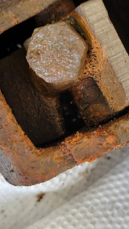

It appears to have been broken and brazed back together. Also, seems to have an oversized bolt to lock it to the shaft.

A great many old pumps have worn or damaged shafts in the seal contact area. The accuracy and type of surface finish at the point where the seal contacts the shaft has to be right or the pump will need to have the packing adjusted very frequently and replaced often. Loose bearings will also assure poor results and the need for frequent adjustment. Debris in the coolant will cause issues with any kind of water pump. "Water pump grease" used to be widely available. As I recall, It was a yellowish, waxy grease. A pump would probably give the best service if the impeller was of a uniform shape and well-balanced. A T water pump might reach 3,000 RPM or more at high engine speeds.

Jerry VanOoteghem wrote:
Tue Nov 01, 2022 8:28 pm
I think that there is also a set screw to hold the bolt in place. It seems like a lot happened in that small space.

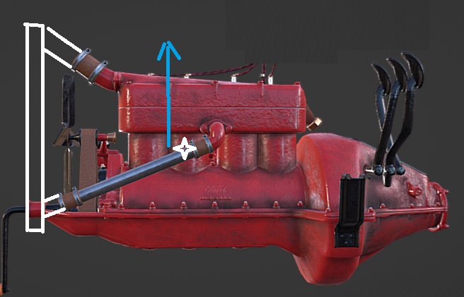

Post by TRDxB2 » Tue Nov 01, 2022 9:53 pm
I have yet to see a fan pulley style Model T water pump that was able to pump coolant any faster than the thermosyphoning action of system provides to it, since the system is not pressurized. The design of this water pump uses the impeller to lift the coolant rather than to push it.
A simple test would be to spin the water pump pulley by some external means to see if could elevate coolant out the water neck hose at the top of the engine on its own. Its been estimated that the water jackets and hoses hold about 1.25 gallons or about 10lbs. So looking the pictures below does it look like that impeller can move coolant, lift/push 10lbs, faster than whats being delivered to it?

Post by TXGOAT2 » Tue Nov 01, 2022 10:07 pm
The pump doesn't have to actually lift the water if the system is properly filled. It simply helps move the water. The pump's suction head and discharge head are very close to equal, as the diagram above shows. The maximum thermosyphon pressure differential is very low at best, yet it is sufficient under most circumstances, assuming the system is clean and the ambient air temperature is moderate and airflow volume through the radiator is sufficient to develop a good thermal differential in the system, from which proceeds the pressure differential that moves the coolant through the system. The accessory T water pumps do not replace the thermosyphon function, they only augment it. The Model A and early V8s had the water pumps in the cylinder head, which is a fundamentally poor design. Ford eventually corrected that flawed design by designing the water pump(s) to move cooled water from the radiator outlet(s) into the lower water jacket, which is how the accessory T pumps are arranged. A stock T system would not tolerate much pressure from a pump, since boosting the water flow by very much would stack water up in the radiator upper tank, where it would be dumped out the overflow. A restricted radiator would aggravate the tendency for a pump to overflow the radiator upper tank, however, the weak suction of the pump at the lower radiator outlet would tend to offset that effect in both cases.

Post by TXGOAT2 » Tue Nov 01, 2022 10:32 pm
There is no lift. The system, onced filled, is balanced. The thermosyphon system alone would be incapable of providing any significant lift, were any lift required. The thermosyphon effect causes the water to flow (gently) by unbalancing the system's hydrostatic balance due the natural expansion of heated water. Heated water weighs less than cooler water, and so the cooler water from the lower raidator tank pushes the hotter water out of the water jacket and into the upper radiator tank. The (centrifugal) pump, if present, provides circulation, or aids it, by physically pushing the water using mechancial energy taken form the fan belt. It does not depend on a temperature differential to move the water. It will move water whenever the engine is operating, regardless of the temperature differential, if any, within the system.

Post by TXGOAT2 » Wed Nov 02, 2022 9:50 am
The thermosyphon system circulates water by reason of the DENSITY DIFFERENTIAL between hot water in the engine water jacket and cooler water in the radiator. It's pretty damned simple. A water pump pushes the water by applying mechanical force to it. In an automotive cooling system, within broad limits, it doesn't matter how rapidly the water moves through the system as far as heat dissipation is concerned. If the water flows more rapidly, it will make more trips through the radiator in any given period of time and thus gets rid of the same amount of heat. Some turbulence in the coolant flow is desireable in that it enhances heat transfer from the hot engine surfaces to the coolant, and vice-versa. Where people get into trouble with "how fast the water goes through the radiator" is when they remove the thermostat on later model vehicles with a high volume water pump. (Particularly on early, low pressure flathead Ford V8 systems) This can cause cavitation on the suction side of the pump at higher engine speeds, and it will lower the pressure in the block and heads, thus encouraging the formation of steam bubbles, and may draw in air at the water pump seal. If the radiator is restricted, it may push water out the overflow at higher engine speeds. In some cases the lower radiator hoses may collapse, which aggravates all of the above. Neither the thermosyphon system, such as used in the Model T, or the pump system, as used on later models, depends on the pump to lift water. A thermosyphon system will not circulate any water at all unless the upper radiator tank is properly filled. A pump system with a typical, low mounted pump can circulate some water if the upper tank is not filled, but you're heading for trouble running a system that way. The Model A and early Ford V8 pump systems were handicapped by reason of having the water pump(s) mounted in the cylinder heads, which is just all wrong. They are less tolerant of low coolant levels than systems with a low mounted pump, among other shortcomings. On the plus side, these systems retain some cooling capacity if the fan belt fails, due to thermosyphon effect. That's not true with most later model systems for a number of reasons. All things considered, the pump/thermostat/pressure cap systems are best by far, and far more versatile and efficient. Some stationary engines used a hopper system, basically an open tank surrounding the cylinder, or a geyser system, where an external tank was used. Circulation in the latter case commenced when the water in the engine jacket began to boil, which would allow some water to spew over into the tank, which caused some cool water from the tank to enter the water jacket via a lower pipe connection. No thermosyphon effect was possible with either of these systems.

To answer the original question yes, it would. A duplicate of this pump has been on a fairly heavy 1924 Depot Hack with an original body and an original black high radiator that has been in our family for 65+ years. It keeps it cool here climbing the Vermont hills and mountains and never boils. It tried it once with the thermo-syphon system, but because the original 98 year old radiator doesn't transfer heat all that well it overheated fairly often without it.

FWIW I removed the top coolant outlet today. There was no thermostat.
Posts: 8667
Post by TXGOAT2 » Wed Nov 02, 2022 8:53 pm
There may be one stuffed in the upper radiator hose.
Arbs
Posts: 216
Last Name: A
Location: Pennsylvania
Board Member Since: 2022
Post by Arbs » Wed Nov 02, 2022 9:03 pm
Nope. None there, and the old top radiator hose is now part of my flush-o-matic 2000...

Post by Arbs » Mon Nov 07, 2022 10:31 am
Pep C Strebeck wrote:
Tue Nov 01, 2022 9:48 pm
While twiddling my thumbs waiting for an order from Langs, I started to clean this pump up and confirmed that there is no set screw holding the bolt. It was an oxidation and sediment formation. The bearings seems sound, with no play in them. This may be a rainy day rebuild project.

Post by Craig Leach » Mon Nov 07, 2022 11:00 am
Hi Dan,
I'm impressed getting the bolt out is usually when I break the impeller. It looks like you have the shaft out. If it is smooth and tight you can
probably repack it with new, clean repaint, and use. ( At your discretion) Keep in mind the packing stuffing nut is also a bushing, also remove
all the old packing.
