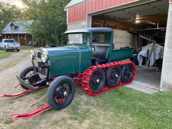

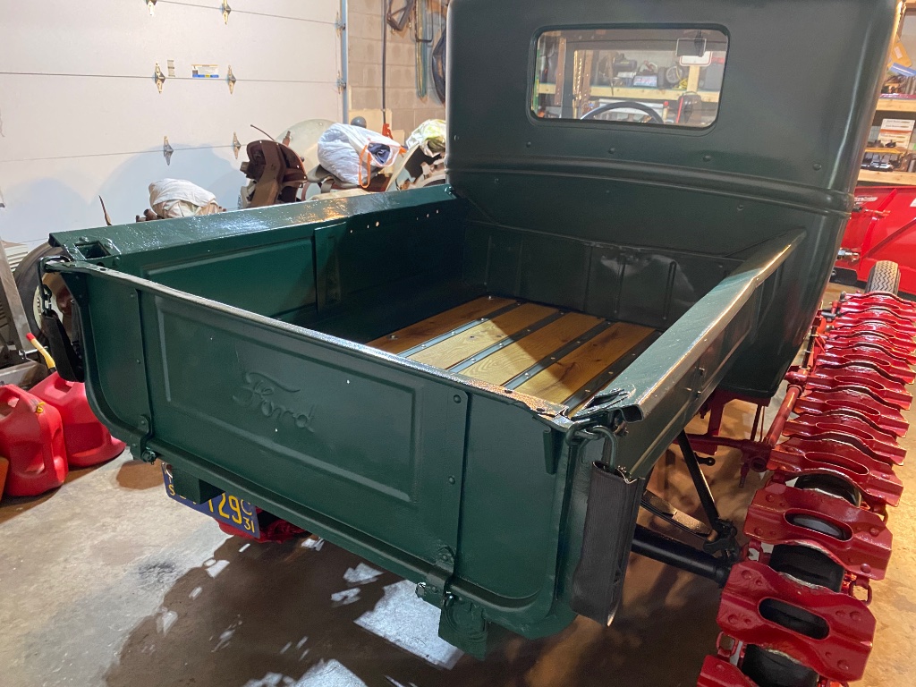

This is a 1931 Model A with a Supersnowbird kit made by ARPS. I chose to paint it red to highlight the parts of the kit. The pickup bed is 26/27 Model T.

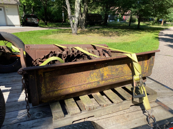

I got new C-clips and spacers from Brian at NH-Snocar to build the tracks, links also to connect them. He makes quite a variety of parts. I sandblasted and made welding repairs to all the track pieces.

Joe - that appears to be a '25 box - '26-'27 had the fender outline similar to a Model A box.
Joe Reid
- Posts: 270
- First Name: Joe
- Last Name: Reid
- Location: Almond WI
Re: Snow Mobile Questions
It could be. It is not Model A. For some reason they bent the Model A frame straight also to accommodate the box. It does use the 26/31 tailgate.
- Posts: 5576
Yes, same tailgate throughout. The stamping in the middle of the box (notice the 2 rivet holes) are for special, one year only rear fender brackets - that's a rare box as it is a one year only also ! Does the front panel have a "kick-out" for the battery access ?

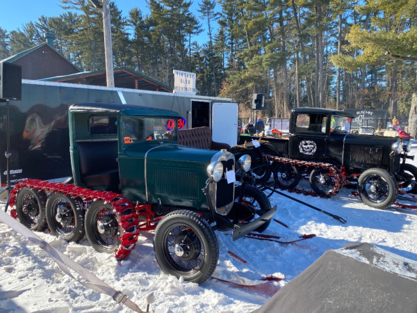

This was last year at the Manawa Snodeo, in Manawa, WI. Two Supersnowbirds.

I have doors to rebuild now. They have to be cut to open over the tracks. I don’t think these were kits you took on and off depending on the season. The Supersnowbird kit is from probably the mid thirties. They were used in big snow areas for RFD delivery, maybe rescue and other snow work.
Joe Reid
- Posts: 270
- First Name: Joe
- Last Name: Reid
I have seen T’s with the idler axle ahead and behind. Behind lengthens the wheel base and keeps everything clear of the doors.

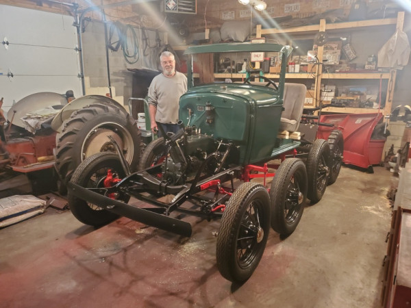

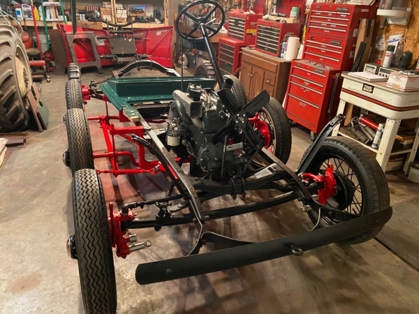

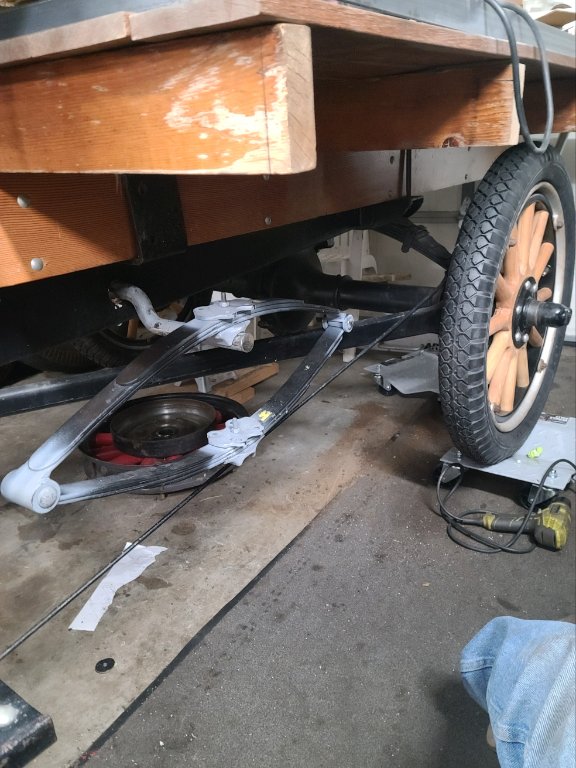

In the midst of biulding one myself
Since high desert and hills or should say mountains here mines based on a TT
Joe Reid
- Posts: 270
- First Name: Joe
- Last Name: Reid
Looks like a good start. Is your rear axle a standard TT axle?

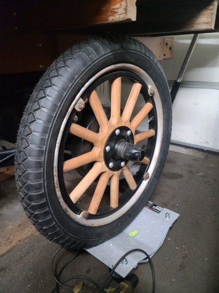

Bob- Who made your rear wheel wood? They sure did a nice job! Glenn
