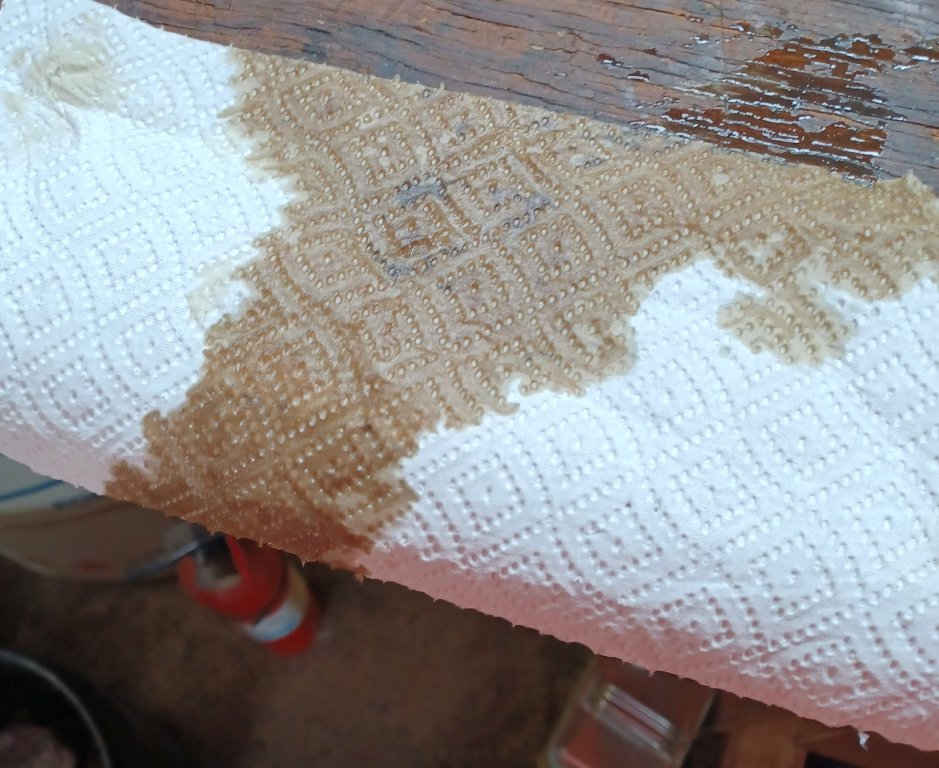

The big question in this topic is. At what point should the engine oil be changed. I am interested what others think

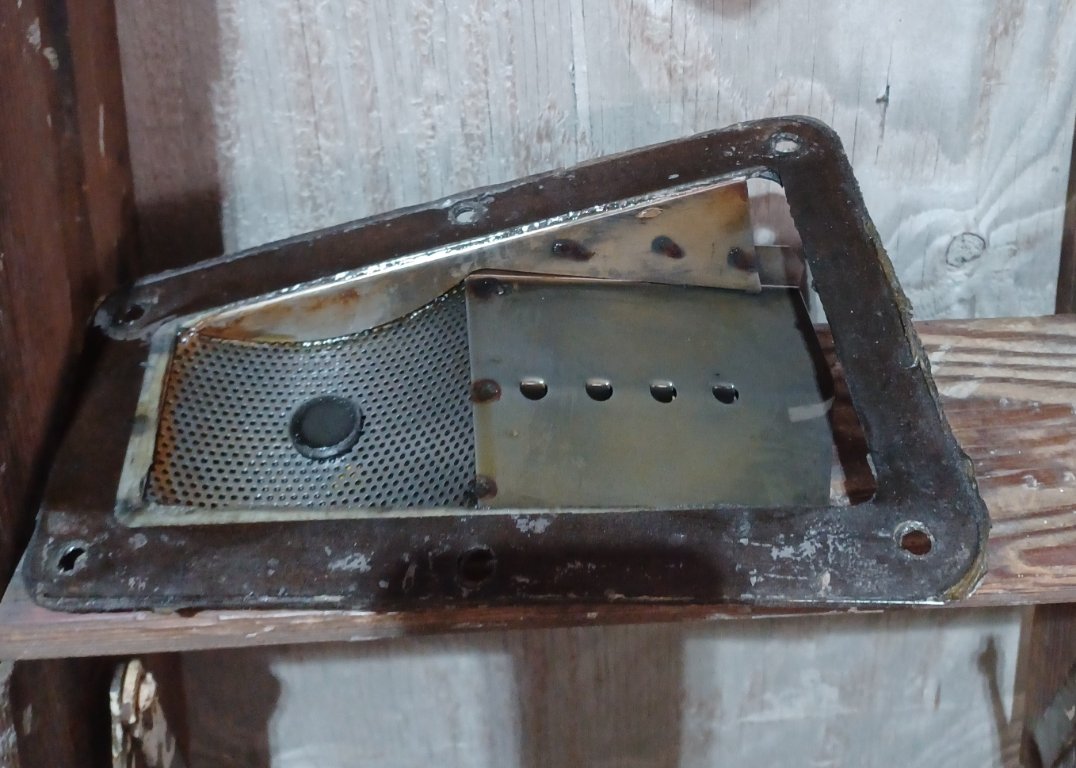

To answer Art M's question:
The pic shows my '13s oil when I put some on a paper towel last week as well as the screen, when I changed it at 1014 miles. Pretty clean still, but I did it for winter layup.
