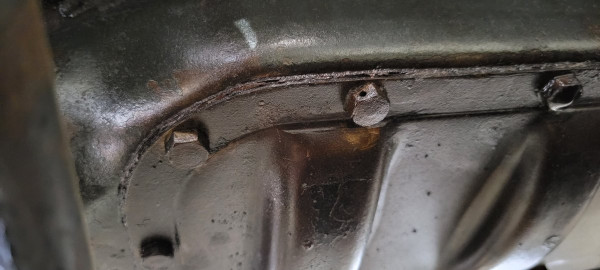

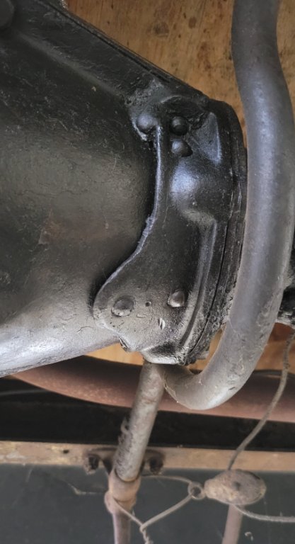

This is the engine pan access plate on a 1912 I am working on. I have to say, I have never seen these bolts safety wired before. A lot of work went into this! Is this "stock" or a custom job? I am guessing custom but am learning something new every day on the early brass T's. Unfortunately, I need to remove this plate as the engine is frozen up so it hurts somewhat to destroy that safety wiring work of art.

It's stock for some 7 rivet pans. By that I mean the holes in the heads of the bolts. I assume they were for safety wires.

Gregory-

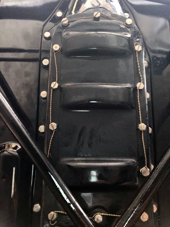

Yes indeed it is absolutely ORIGINAL with the introduction of the inspection cover in 1911. And beautifully done, too.
Be sure to notice that the edge of the inspection cover has a recessed edge, about an inch wide. This is a detail that is often overlooked on early cars.

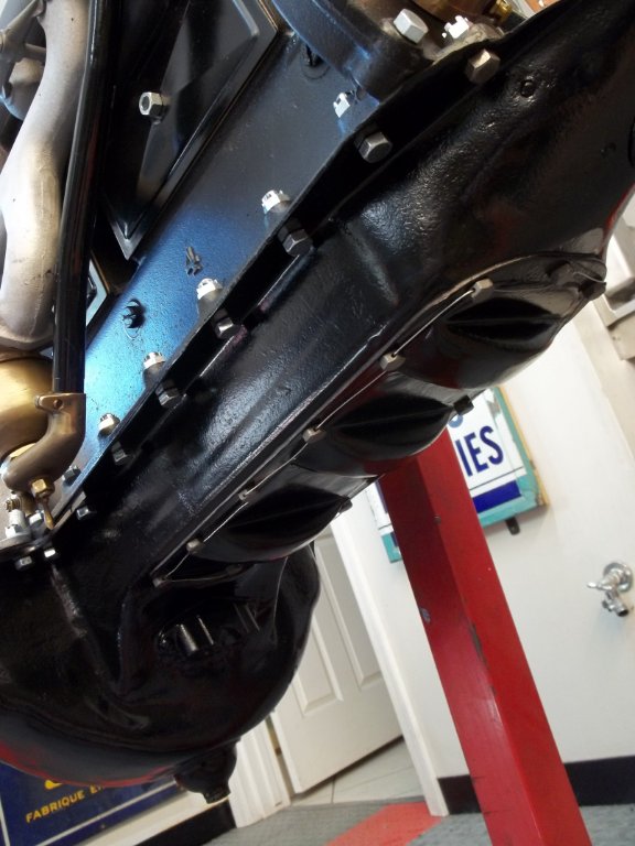

It is the same as on mine. Here it is on Phil Mino's (RIP) car (missing the wire):
Is there a reinforcement "bulge" at the and of the pan, too?

The "safety wire" used on early pans with inspection plates is totally correct and original. This is a fine point that is often overlooked when 1911 and early 1912 Fords are restored. The inspection plate is also unique in that it has a "ridge" going around the plate where the bolts are placed and the oil sumps are more pronounced and a bit deeper. You may notice that I installed reinforcing plates between the engine and transmission cover for strength (These plares are covered by the engine pans.) Here are a few photos of my 1911 Torpedo engine. I hope this helps, Russ Furstnow

If you are concerned about originality, the way the bolts are wired originally should be considered also.
The way & type of wire this cover is wired with looks extra fancy to what Ford would have done.

I would be interested in knowing how they were wired originally.

I would bet that a single strand of brass wire run through all bolts and then twisted like a twist-tie on bread. There are a number of other, similar places where this was the case originally and I doubt that anything more involved would have been done

I can't tell you for a fact how Ford wired their inspection pan bolts, But I can tell you that there are well documented instructions for correctly safety wiring airplane parts. Whether the airplane guidelines really do apply to automobiles is probably up to you.
The aircraft guidelines govern the size of wire, type of wire, number of twists per inch of the two wire strands, maximum number of bolts to be tied in a string, and correct direction of wires at bolt heads.
Many of those guidelines are probably trivial, but the correct direction of the wires is quite important. As you run the wire through each bolt head, you should arrange the direction of the wire so that the tension of the wire tends to tighten the bolt, not loosen it. If you check your pan wire, I believe you will find the first three bolts on one side string to be backwards. Ditto for the first two bolts on the opposite side.
To test the direction of your finished job, put your imaginary wrench on each bolt head and turn the bolt as to loosen it. Turning the head to loosen the bolt should tighten the wire Or, looked at it from the perspective of the wire, the correct direction will be when the wire tension wants to tighten the bolt.
Don't feel badly about a backward safety wire job. After thirty years as a certified aircraft mechanic I still find I've done it backwards from time to time.
One other thing. As I recall, the maximum number of bolts wired in a string is usually three. Too many bolts wired together may fatigue the wire and make it too brittle. Also, it's a lot easier to unwire fewer links if you find an error in your work.

The Seventh Edition MTFCI Judging Guidelines state for the 1911 crankcase:
"Single piece design with no inspection cover. Arms (T-815) were secured with seven rivets. Removable cover with embossed edges appeared around April 1911. Some cover bolts were drilled for lock wire. Oil drain was the "tea cup" style and drain plug was the slotted style."
For the 1912 crankcase, it says:
"Removable bottom design with seven-rivet support arms and teacup style drain with slotted plug."
No mention of embossed edges or lock wire in early 1912.

Perhaps the factory left the wire off, and a dealer would install it after the new car had been run in and any adjustments made.
