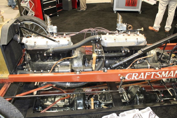

Does anyone have any input or leads as to how this dual engine was made? I have a mad idea and spare parts!

You'd certainly need a flex coupling. I'd think the forward engine would run hot, if they both didn't. Who built this thing? Tommy Ivo's grand dad?

Wonder how it cooled with the hot water from the front engine running into the 2nd engine and then to the radiator?

Well, it's got a water pump on the rear engine. That and some MMO ought to keep everything nice and cool. If not, there's always SLICK 50!

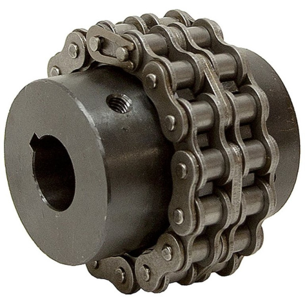

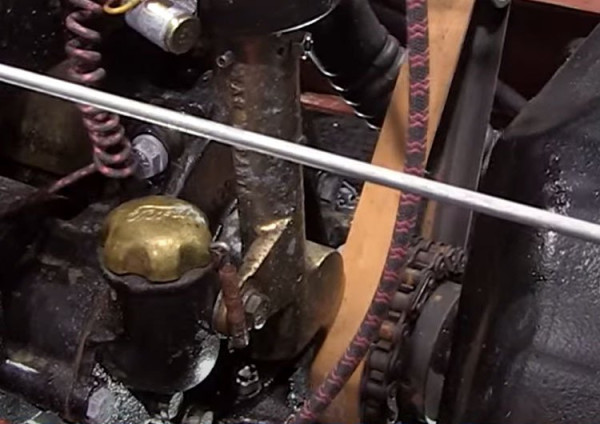

I clipped this from the video. I think I see a roller chain coupling which is simply two sprockets joined by dual chain. that would certainly be a flexible coupling. "Toolmaker Craftsman teamed up with series organizers to build what it dubbed "the Craftsman racer." We liked it."
