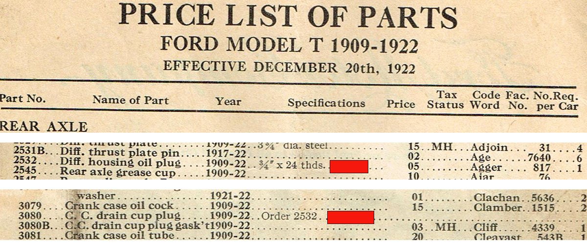

Part #3080 3/4-24 tpi. It is the same as the differential oil plug #2532
My source:

Rich -- Part number 3080 at Lang's is the plug, but the listing doesn't mention the thread count. I have plugs but need a tap the right size. If you're sure that it's 24 tpi, I'll go ahead and order one. (Edit) I now see that you've posted a chart with that info. Thanks!

24 threads is correct. Otis Clinton used to have a tap for that. I wonder if they are available?
