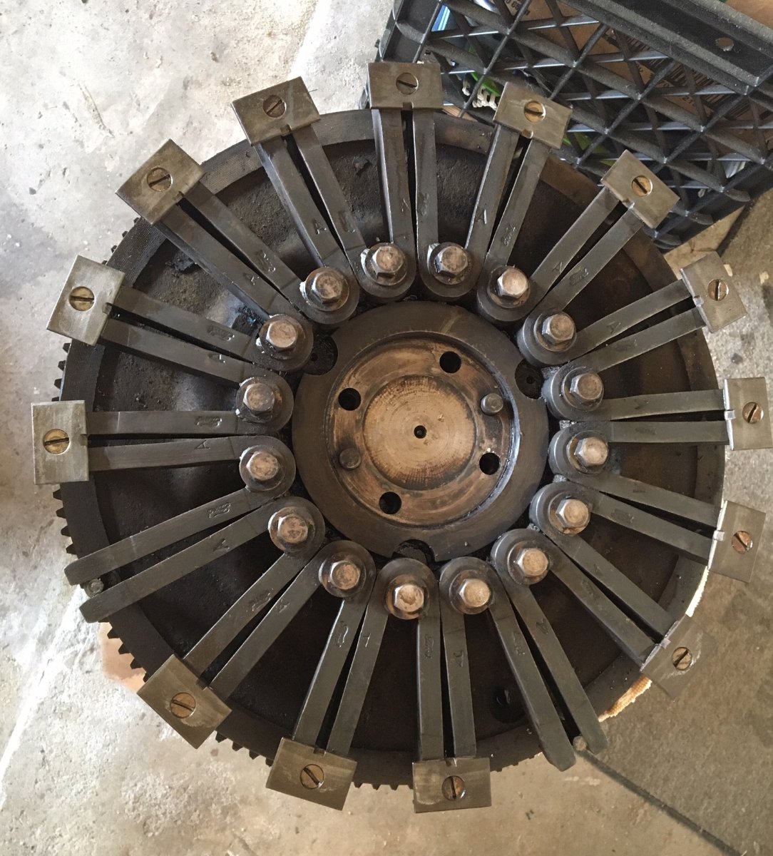

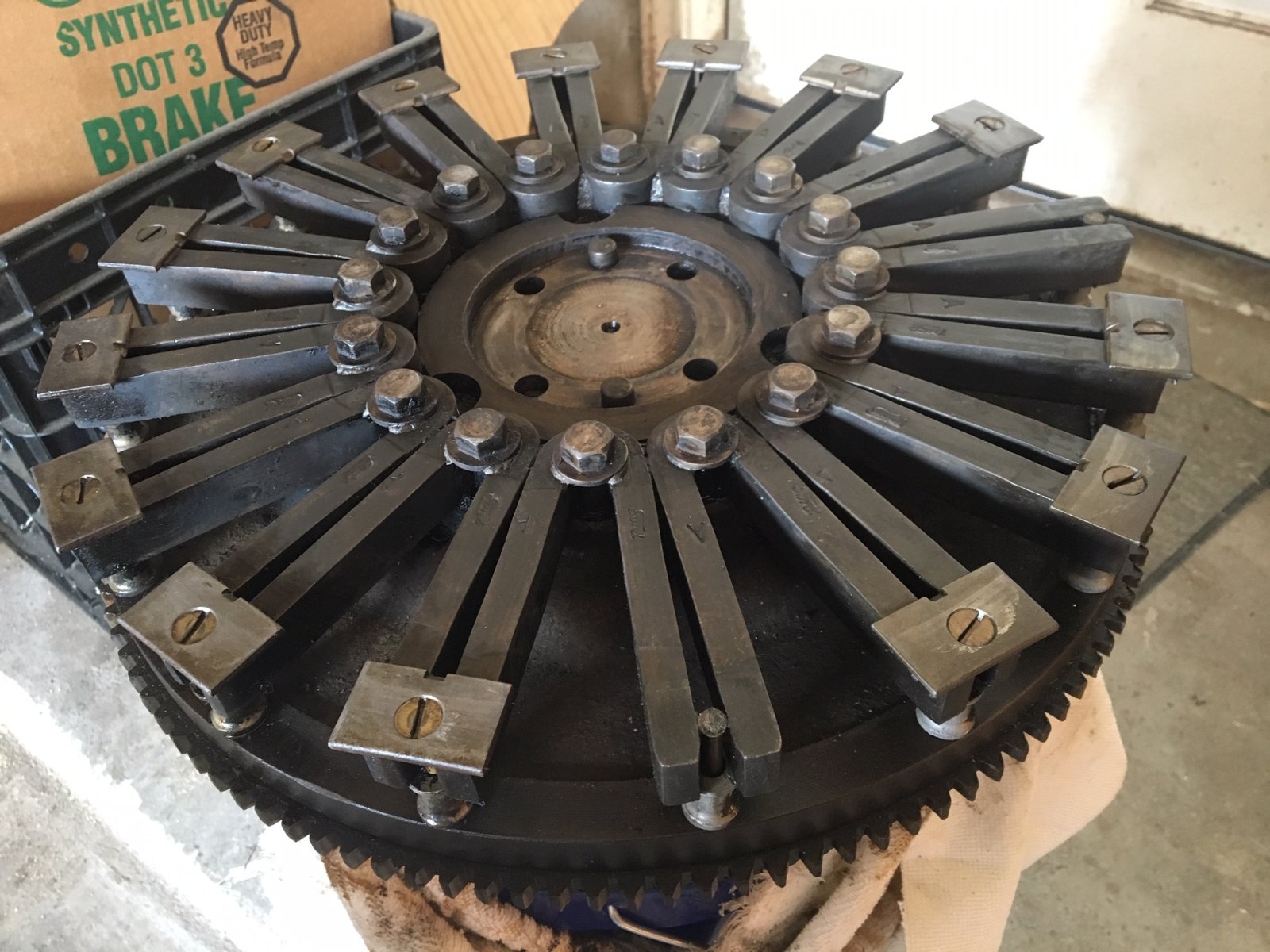

Post by Steve Jelf » Mon Apr 22, 2019 10:51 pm
I agree with Scott about shimming up the low magnets rather than pounding down the high ones.
I don't remember what the shim stock cost, but it can't be terribly expensive.
