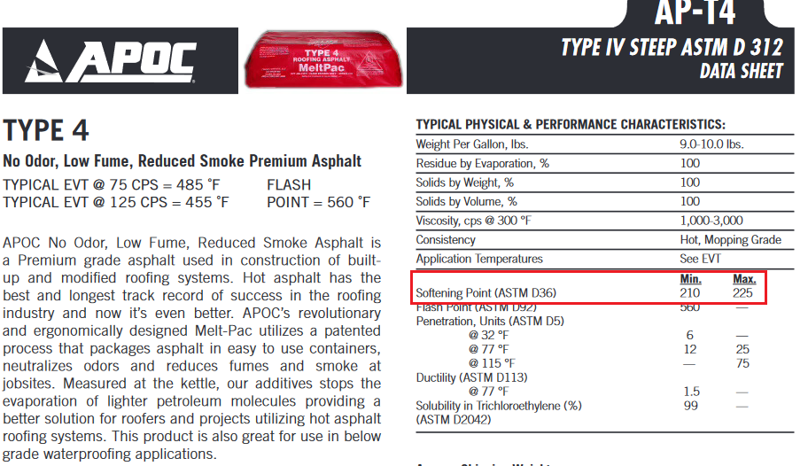

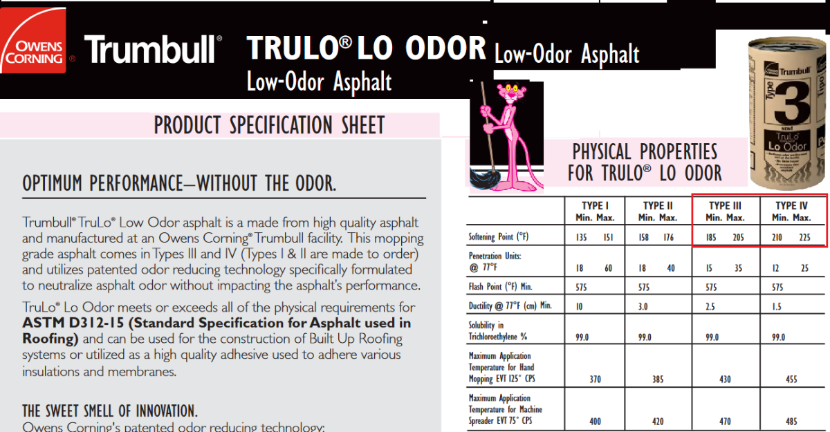

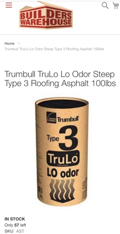

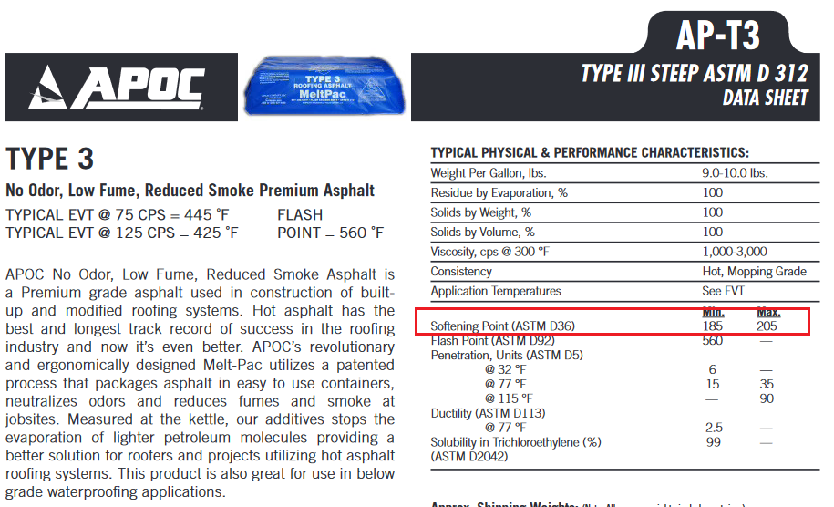

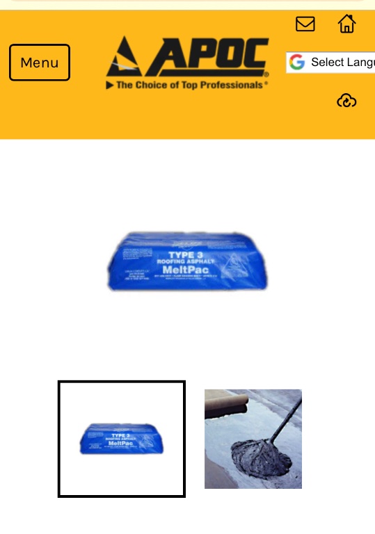

A source of supply Beacon Roofing Supply, Inc. looks like a National chain. even have a location near me.
store locator> https://www.becn.com/find-a-store
The Apoc Type 3 &4 melt packs weigh 50lbs each. Type 4 has a slightly higher temperature range
The Trumbull comes in 100lbs drum

Type 3 was required for the 1926-27 coils sitting on the head and getting hotter than the earlier coils.
15 years ago, I had to get the whole 100 pound barrel of Type 3 like shown above.
That was from South America and evidently not allowed to be sent through the mail, as it is explosive when over-heated and burns good too.
The cost was $80 then, so it is about twice that or more.
Your best bet is to find a local roofing company that does large commercial buildings and will give you a few pounds.
