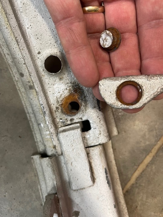

So I was pulling the tire off with my hands and some tire irons. and this happened.
Is there any repair for this? Yes I was using a rim splitter but that was off the rim when it happened. I think the edge of the split must have hit it.

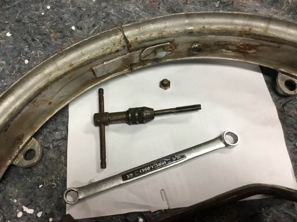

Early in 2022, while installing new Goodyear flaps, tubes and tires on my split rims, I broke all four latches while turning the latch to release the rims. Turns out after 52 years (I had last installed new tires in 1970) the latches were badly rusted.
All 4 latches were repaired using the following procedure:
1. Using a larger tap, re-tap the hole.
2. Bolt on the latch (I used stainless steel bolts to prevent rust in the future). Make the bolt tight, but not so tight that the latch cannot turn using a hammer and punch.
3. Using an angle grinder, grind off the excess threads on the interior side of the rim leaving about 1/16” protruding in order to brad it flat.
4. Spot weld or brad the threaded end to prevent from loosening. As you can see in my last picture, I left the threaded end about 1/16” long and beat (braded) the end down using a ball pien hammer.
5. Lastly, grind down the majority of the hex head (Optional. The rim will go onto the spoked rim without grinding down the head). Jim Patrick

Mark I was using the correct spreader and was able to do 4 tires with it. This would be a spare. The spreader was not on the tire at the time. The tire was so old (It was put on in 1974) that it was as hard a plastic. So I was cutting it off with a hacksaw. While I was doing this the side of the split hit the latch and must have broken it.

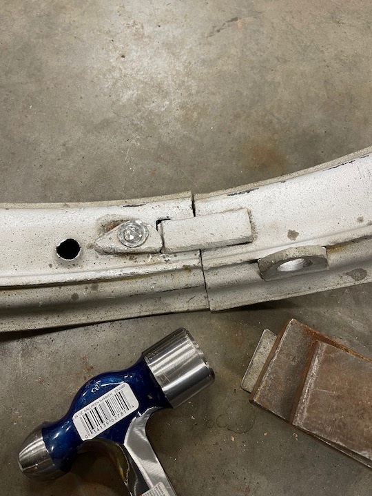

Well I was able to fix it! I used a barrage blot cut to size then a washer on the other side. I had a metal bucking board and a ball peen hammer. The latch came out a little loose but when I put the rim together it tightened up so I could use a punch and hammer to slide it in place.
