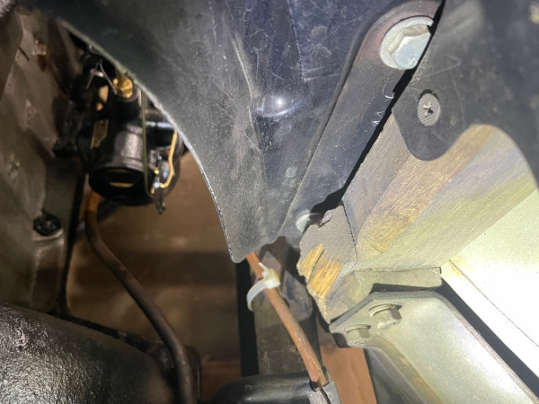

So I got home from work, took the floor boards out, and found what looks like a block added to the wood frame to move the frame mount back and the body forward about half an inch (see the picture). This does not look right. It amazes me the length folks will go to do something wrong.

Well, you've just answered the question as to why the body is crowding the hood
Now you're in a bit of a pickle regarding at least the forward brackets as the carriage bolts which mount it to the main sill are covered over by body skin. As you have cyphered out by now, that bracket must go "forward" in order to pull the body "backward" (as well as the other mounts as well).
I personally would pull the 3 nuts holding it to the main rail, remove the forward blocks that do not belong there and weld the carriage bolt holes closed and redrill them over the necessary 1/2" or so to pull the body back. Or conversely weld the mount hole closed in the bracket and redrill (I am suggesting this without having looked at my runabout, so don't know which I'd personally chose right now).

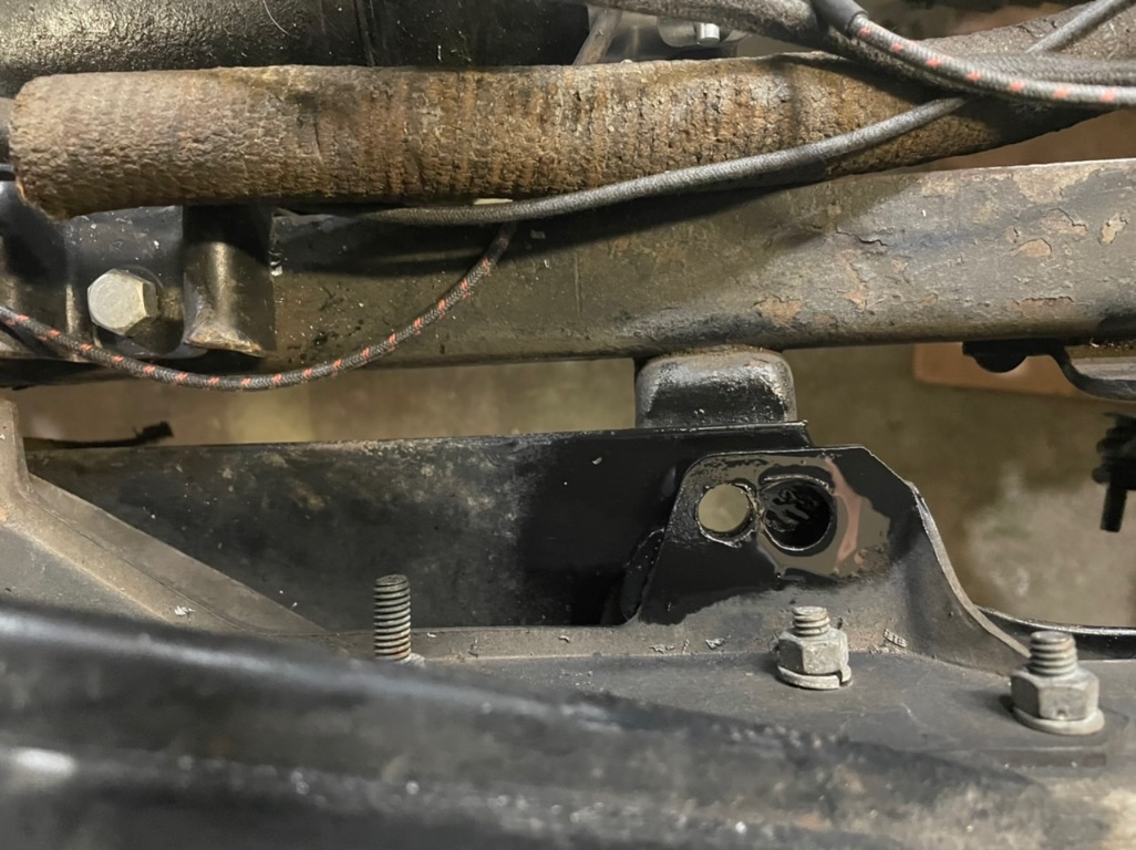

With a sharp chisel and some patience I can get the blocks off without removing the bolts. Then I will move the brackets to where they should be. It’s easy to plug and re-drill the holes in the wood.

perhaps the guy lag-screwed the brackets into the main sill? That was the problem that I thought you'd have...that being with the carriage bolts coming in from the outside (side) and not being able to get rid of them sufficiently to plug the holes in the main sill(s)...good luck and glad you found the source of your grief.

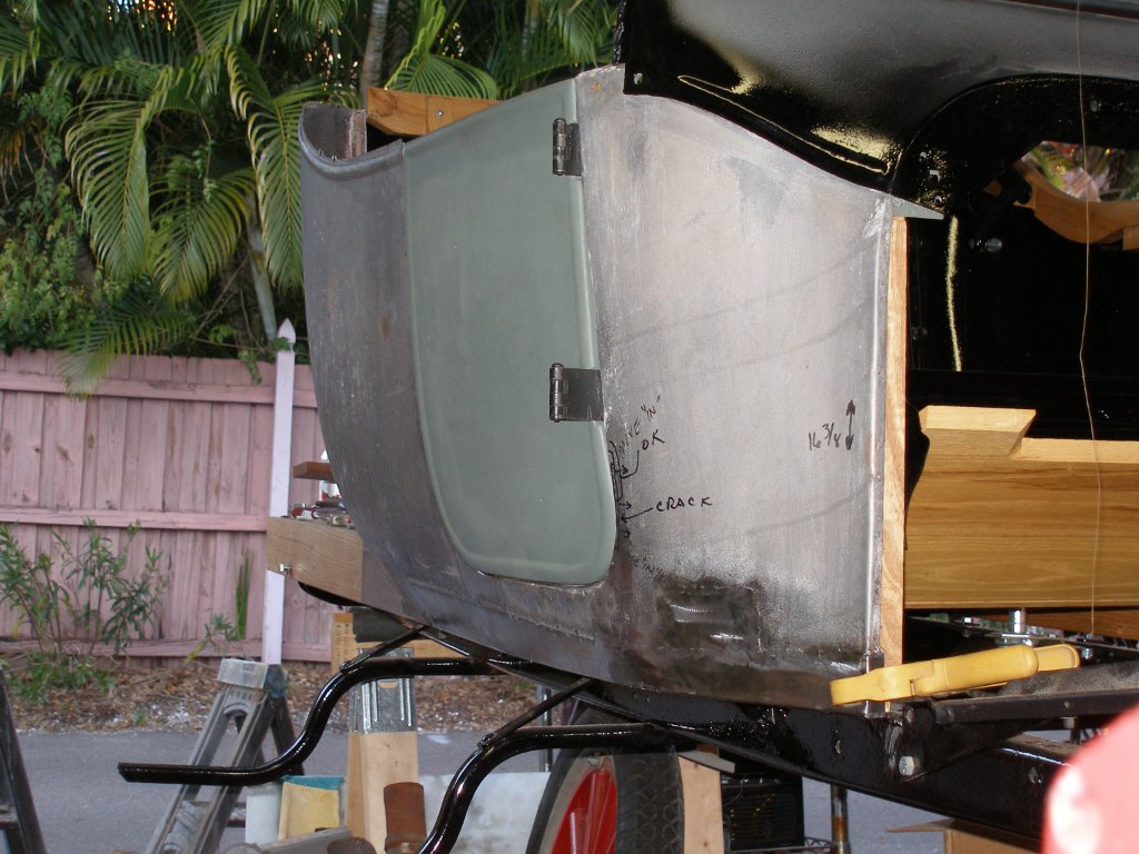

The rear fender brace is the problem. The best thing to do would be to leave the bracket in the correct place, unbolt the fender brace, slide the body to the correct position, re drill the holes for the bolts holding the fender bracket and reinstall them. This will lead to an extra visible hole in the side of the body. I could replace the sheet metal so the hole is not visible.
I think modifying the brackets is the way to go for now. But it has gotten me thinking about how one would get the sheet metal off the wood. I have not been able to find any detailed information on how the sheet metal is attached in the books I have or on line.

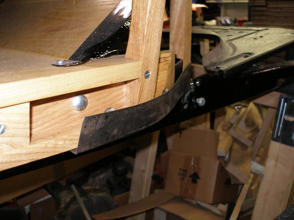

Lots of small nails
It is a big job to remove the skin...difficult to do with healthy wood
On the up-side, that piece of metal that covers the sill at the rear fender bracket is an easy fabrication, so after thinking about it, I agree on plugging the holes in the wood for that bracket, replacing the sheet metal and moving that bracket...those bolts actually go the other way...from the inside out...are easily removed...I'd forgotten about that in my earlier posts.

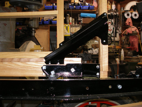

This is what the area SHOULD look like...i.e. no extra block between the body bracket and cowl riser:
