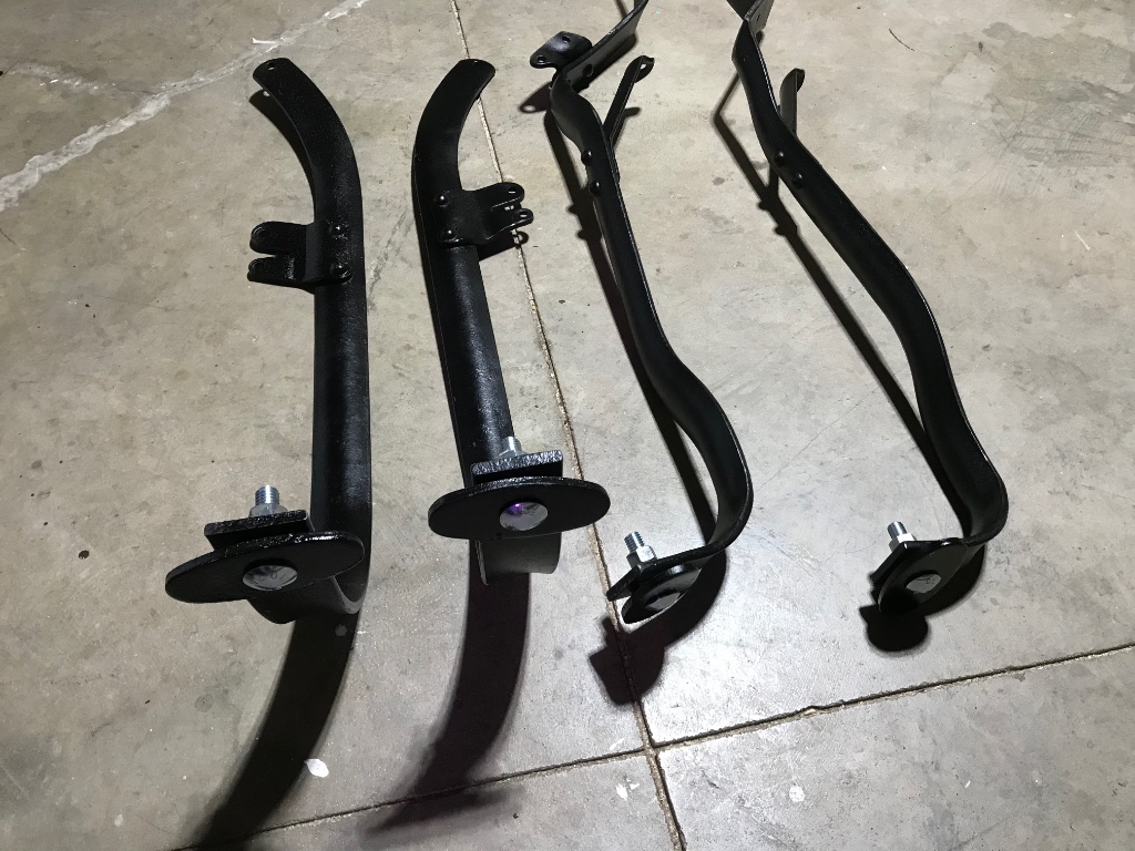

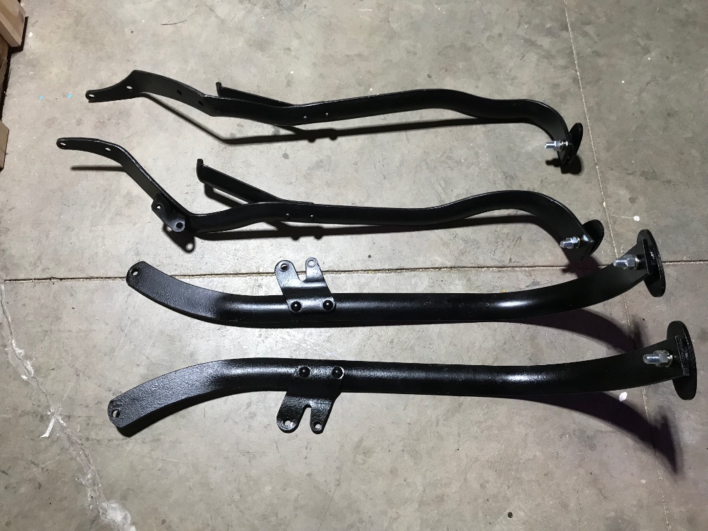

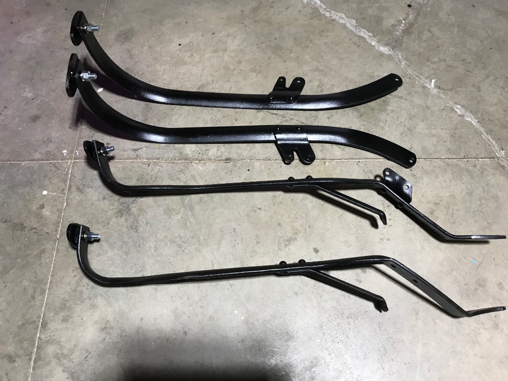

Please find photos of bumper brackets, I purchased. They look to be 26-27 Model T. Can Someone confirm, for me.
I realize the Model T didn’t come with bumpers in 1924 but, I hoping to attach them to mine. Has anyone done it?

I will confirm they are 26-27 Ford.

George, They would appear to be correct for 26-7 but be aware that the rear brackets come in two different lengths. Longer for the coupe and roadster shorter for the sedans and tourings. Jim
