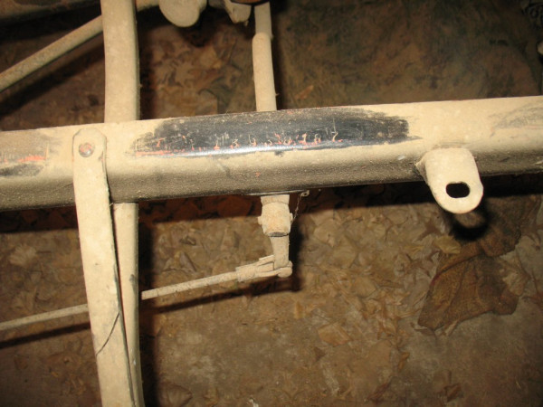

Ford didn't "go back" to putting the engine number on the frame. That was never done before December 12, 1925. Before that date the engine serial number is the only VIN. That doesn't mean that the engine number couldn't have been stamped on the frame by "somebody". The frame location of the serial number is on top of the rail under the floor board, usually the right rail, directly over the hand brake shaft.

If the CHP is anything like our vehicle registration branch, they will have a form, with a box for the vin number, which needs to be filled in. Rather than fight them to get them to realise their form should not apply to your vehicle, it has been easier to stamp a number on the frame and show them where it is. Box filled!!! I have a T with my birthdate, another with my Army regimental no. and a third with most of my phone number. Everyone is happy. All boxes ticked.

A long time ago, when I was still in high school and very interested in antique automobiles, I got to know an interesting old fellow. I met him through my dad's business connections in an out of the way Northern part of the state. He was at that time a retired sheriff's deputy. He told me many stories of how when he first went to work as a sheriff's deputy in 1921, his first tasks were to drive out to ranches scattered in the hills, and stamp serial numbers onto the model T frames. He claimed to have done a hundred or more over several years. He said there was no specific location for them. There were several common locations for the numbers (front of frame cross member was one!), and sometimes the location chosen was whatever happened to be most handy. He told me about one he put on the front cross member because the rancher hadn't finished fixing the Ford and its new motor, so the car was jammed against a wall where he couldn't get to his preferred spot. He liked the side of the frame rail under the left front fender. Top of frame rail under the floorboards was another popular spot. Even on Ts too early to have the improved model's numbers by the factory. I have seen a couple of those myself.
