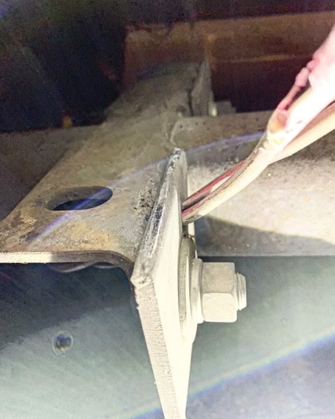

For the past several months I have pulling an
all aluminum custom built enclosed car
hauler trailer on a dally basis.
This warning applies to all trailers ⚠️
Check your axle mounting plates ✅
On my tandem 5200 pound torsion axle
trailer - the passenger mounting plate
on the front axle completely broke
and separated the axle from the trailer:
This happened in a two hour span
over 100 miles without any noticeable
prior warning signs - although the axle
plate probably was cracking for awhile.
Prior to this - I didn’t consider axle mounting
plates a necessary inspection item for
trailer maintenance - but now I do.
The axle plates are aluminum and are
welded to the aluminum square tube
frame - but this can happen with steel
axle plates as well.
If you own a trailer - check each axle plate
to make sure they are not cracking ….

I spent a few hours today chasing down
material - prepping the trailer for the
certified welder who is coming tomorrow
morning to do repairs.
The trailer manufacturer did not use
stock aluminum angle - they either
rolled 1/4 “ stock or welded two
flat pieces together to make the
90 degree angle … 👎
After repairing the broken mounting plate
the remaining three aluminum torsion
axle plates will be inspected - repaired
and reinforced.
I just took a video of the axle and
posted it on YouTube:
@ https://youtu.be/OPqG1SsZeBs

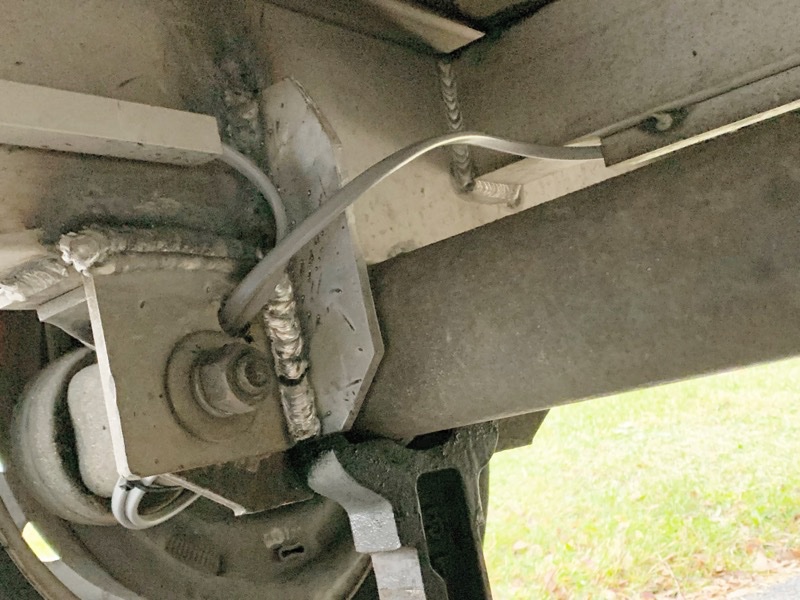

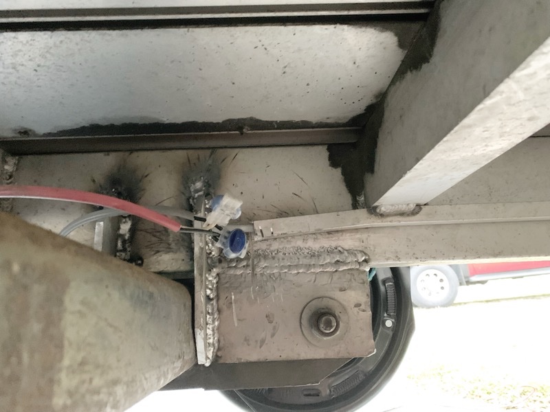

Post by FreighTer Jim » Wed Nov 16, 2022 7:11 pm
Left side of front passenger side aluminum
axle mounting plate that broke off after
my certified welder John repaired
it & reinforced it to the frame:
Right side of front passenger side aluminum
The other three plates had cracks repaired
and were reinforced in a similar manner
by my certified welder John:

Looks like a good repair, Jim. Puts the load through the welds in shear rather than in bending. That's as good as possible given the all-aluminum construction.
I'd still keep the joint on my inspection list, but I'm confident that it will significantly outlast the original design. And the welds themselves appear to be good quality.
