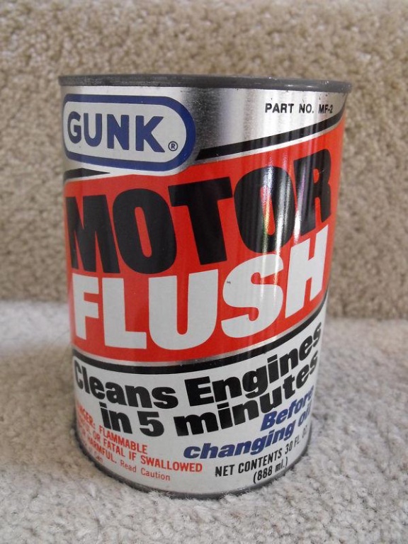

Remove the spark plugs (to minimize compression), disengage the clutch plates (to allow solution between the plates), pour in a couple of quarts of “Gunk, Motor Flush” and turn it over using the crank or starter. The motor flush will penetrate between the clutch plates and soften the sticky oil. When done, engage the plates to squeeze out the solution of motor flush and old oil and drain. Pour in new oil. It should turn over much easier. Jim Patrick
