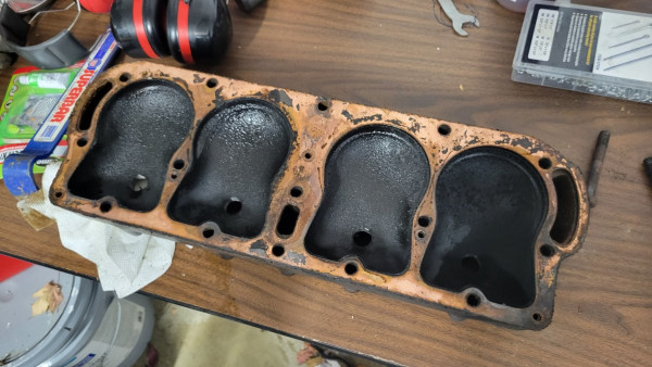

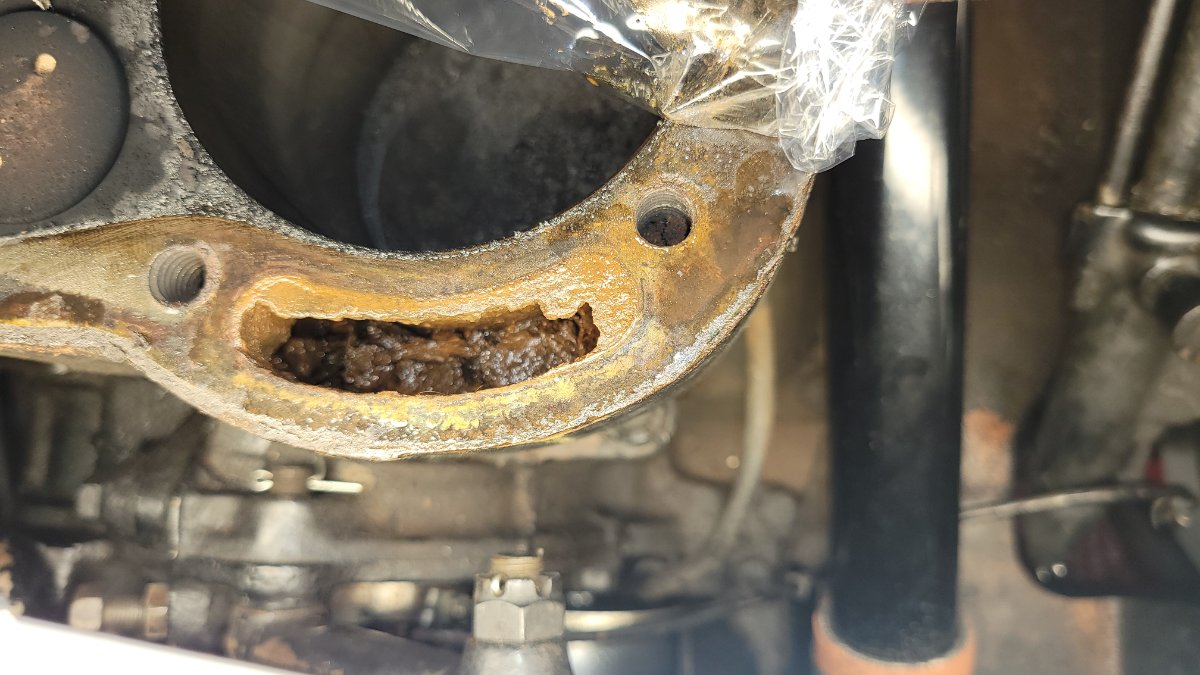

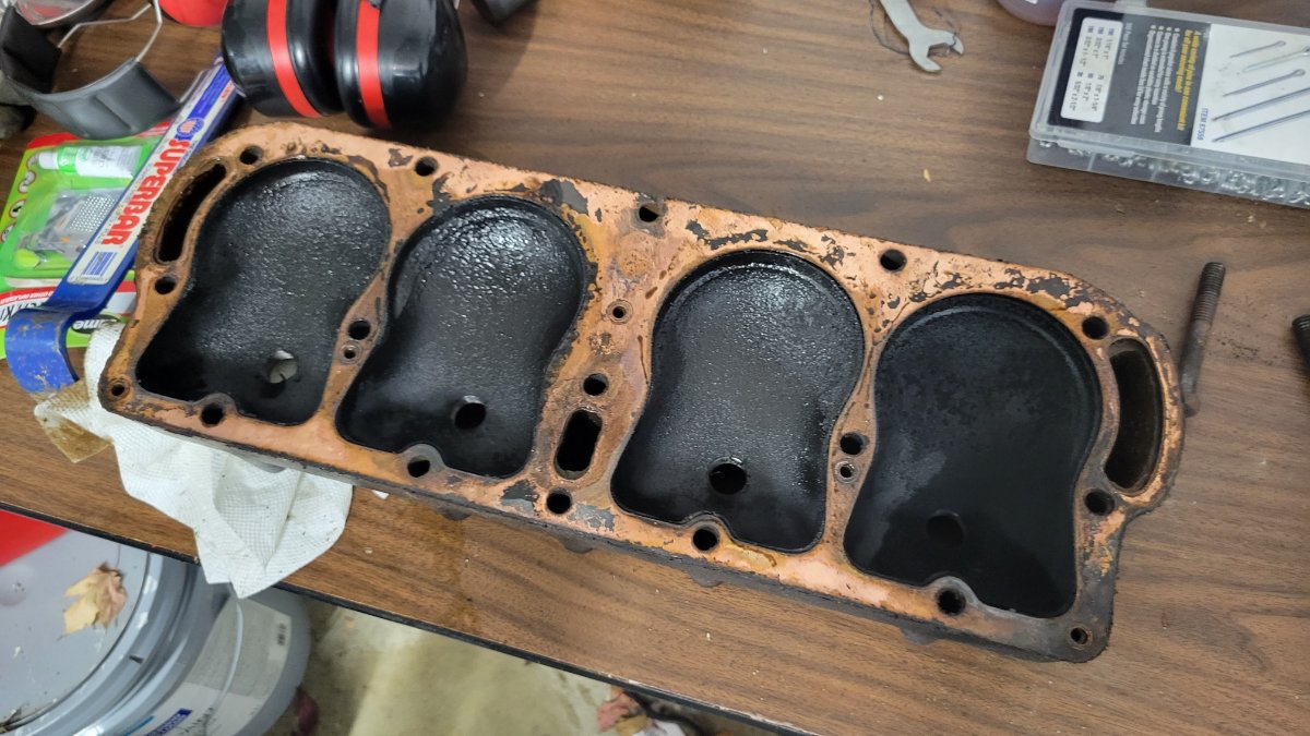

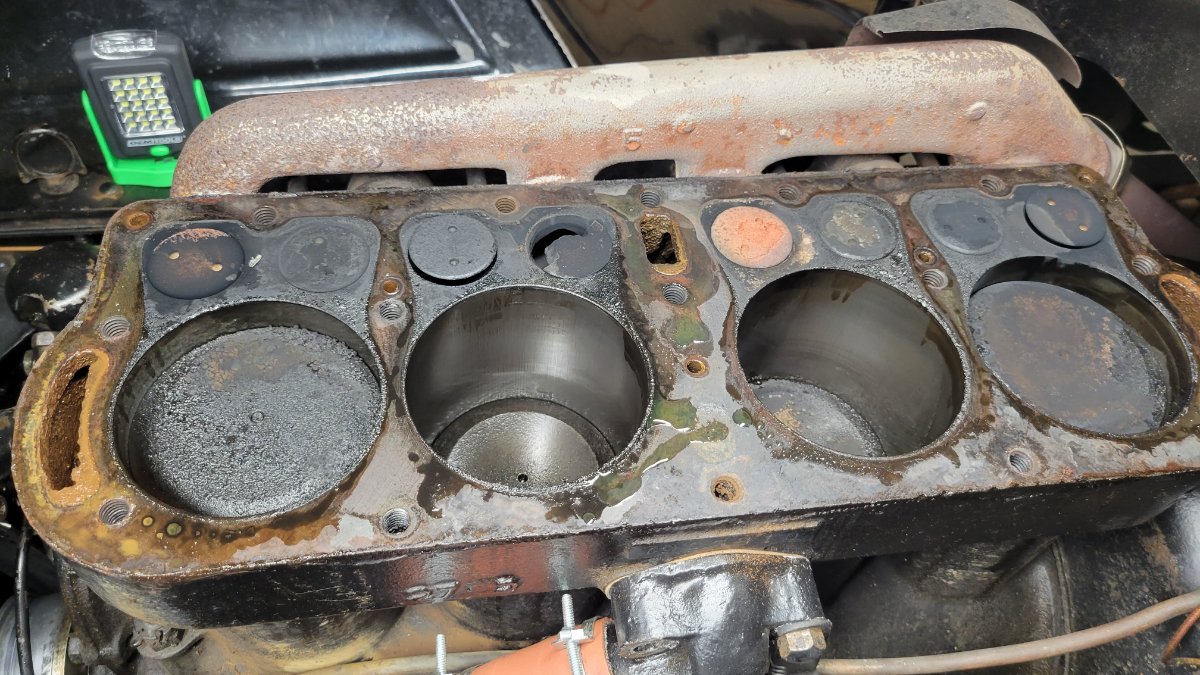

Greetings all! After a recent drive my T has encouraged me to replace the valves. Since I have the head off I'd like your advice on how to clean the head and block. There is a ton of carbon on both. The block has a bunch of sludge in the coolant passages. While you're typing away, do you have any concerns around reusing the head gasket? Should I just spring for a new one? The head came right off of the block, so no tools were used to pry it apart and possibly damage the gasket. Is there any other maintenance I should be thinking of while I'm here?
Thanks for your suggestions!

Not sludge, it is rust and minerals from using tap water as coolant. Easier to address with the head still on. Drain the coolant, fill with vinegar, run the engine and let sit a few days, repeat as necessary. For the carbon, scrape with a screwdriver to remove.

I'd not use that head gasket again, especially now replacements are available again. I would be checking the area at the back of the block and cylinder head around the large water jacket crescent to make sure there were no leaks. The deposits on the gasket may indicate that it wasn't an optimum seal at that point.

Use care when scraping carbon off combustion chamber and gasket surfaces. Do not remove any metal. I've used an old shop vac to vacuum up loosened carbon and gasket debris. Do not use a vac or electric drill around gasoline or any solvents. I'd flush any loose material out of the block and radiator with water. As for the crankcase and valve chamber area area, about all you can do is remove what you can reach, paying special attention to the areas where material could settle. I would not re-use the gasket. It's not necessary to remove every trace of carbon. It's very important not to gouge up the surfaces. It's important to get loose carbon debris out of the space between the pistons and cylinder walls. Use rags to keep as much of it out of this area as possible when cleaning carbon. When you are through removing carbon, put some oil on top each piston and rock the engiune back and forth a few degrees. That will usually bring some loose carbon up out of the space between the piston and cylinder where it can be wiped up. I'd do that several times with each cylinder until the oil pushed up the cylinder wall is free of any debris. Make absolutely sure all bolt holes are clean all the way to the bottom. Cylinder head bolts may need replacement.

This is where Scotch-Brite pads and Kerosene are your friend. Things will clean up nicely.
I position pistons below deck surface and run a bead of "caulk" using grease, around the top/OD of the pistons to catch the crud that might find its way past any rags placed into the cylinders and keep it from the rings. After cleaning everything on the deck spotless, you can remove the rags, carefully, and the bulk of the grease which if previously undisturbed will hold all of the potentially damaging corruption that got past the rags. Bring a pair of pistons "up", re-caulk, and scrape the TOPS, not down on the chamfer or into the grease...whatever is there will not bother a thing. Clean out the grease and bring the other pair to the top and repeat.

I don't know the reason for removing the head, however observing the valves it looks like the original type with the two piece heads and stems. Number 2 exhaust valve has either been removed or the head came off. Number 3 exhaust looks like it is burnt. The top of piston number 2 looks like a new piston. Did the valve break and damage the piston? So if you plan to take the engine to a machine shop, they usually have a tank for cleaning the engine. If not, you can carefully scrape the surface and run a plumber's snake through the water passages. I would also encourage replacing the freeze plugs while things are apart And also replace the rings and adjust the bearings. If the cylinders are tapered, you might also re-bore and replace the pistons. Check the rods for balance and for straightness. if the babbit is cracked or worn out, re-babbit the rods. If you do so, but should check the crankshaft and regrind if out of spec. Also check the crank for straightness and cracks. Might need a new crankshaft. Anyway, read the specs and fix everything you can find wrong and then you won't need to pull things apart so soon in the future.

To have the head off is a golden opportunity to take it to a machine shop, have it cleaned…beaded….and checked for true….from my experience?
I’ve never NOT had a head that didn’t need to be milled some…..IMHO!

Yes, I would re-use the head gasket. But first, put it back together, Fill radiator with Evaporust, run to temperature for 2-3 days, letting it sit in between, then drain.
I don’t know why Vinegar is pushed and recommended on this forum, it’s an old wives tale that is ineffective, stinks to high heaven and stains everything it touches.

" The deposits on the gasket may indicate that it wasn't an optimum seal",,,,,,,
Those deposits on the block and gasket look like RTV sealant used in a previous rebuild, which if correct, confirms the quotation. jb

Question: How did this engine perform before the valve failure? Did it show evidence of severe general wear? It clearly needs the valves replaced, but that may be enough to get a good running car.

Vinegar is very good for dissolving lime and calcium deposits which come from "hard" water, especially well water. I don't know whether or not it works on rust.

As I understand it, the engine is still in the car, which was in driving condition until the 2 piece valve reached the end of its service life.

Use 10% vinegar. It will attack rust and aluminum oxide.
