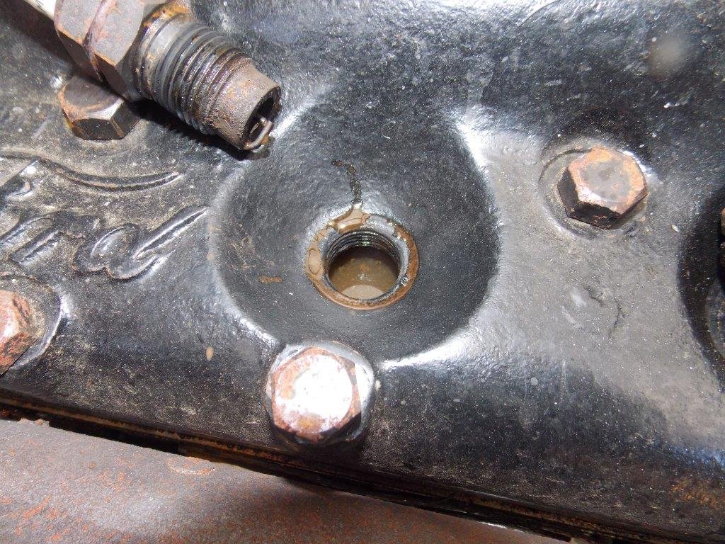

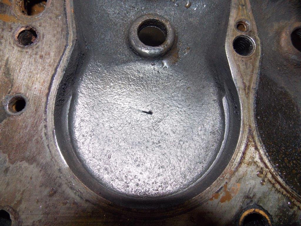

On the 1926 touring I took 0.10" off the head.
No problems with the HC pistons but three year later I found this:
Good luck
Andre
Belgium
Good luck
Andre
Belgium

There is a small hole in the head about where the center of the bore is. The picture with the spark plug out shows a pool of water in the cylinder before the head was removed. I'd guess this head had a flaw in the casting that eventually failed. Persistent detonation could also cause such a hole, though a piston will usually fail first.

Les,
as Pat said. A few years after I installed the milled head the engine started to smoke a lot and was running on 3 cylinders.
As I took out the sparkplug I found water in the cylinder. The head off the engine showed the holl. I think it was corrosion. With a few taps with a small hammer the hole went bigger.
Changed the head with a good one with less milled off .
I still don't know if the problem had to do with 0.10" milled off head.
Andre
Belgium

- Posts: 5271
Re: Maximum milling of a low head
The milling had nothing to do with the leak.
Excessive milling typically presents as a long crack in the piston side of the combustion chamber.
